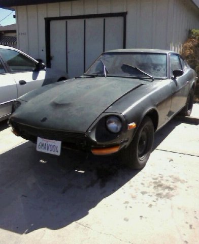

Thank you, Did some very minor bondo work, I'm 21 and unemployed with a poor income I decided to hold back on the expensive shop bodywork a few months. I cut out the floor panels (?) from a donor junkyard car, as well as the corners underneath the doors. But for the mean while I went with bondo and spray paint, doesn't look decent at all but for the look I'm going for it really doesn't matter, and it beats driving with rust holes all over.

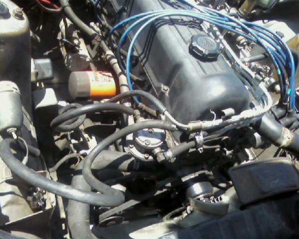

That's good news, I read somewhere that all the emission control in the 260z lowered the HP, (thanks previous owner) I actually got the car running today, took off the pump and tested it with a battery and wire, it worked perfectly fine! I think the ground wasn't connected right or something to do with the wiring, car ran smooth and loud due to a cut exhaust... But with my luck, the fan was scrapping against the radiator I assume. I revved the engine and it chipped the radiator and water squirted everywhere. Another "to do" on the "to do list" I'm taking it to Tijuana twenty bucks is going to get me a welded and cleaned radiator. To do list: 1. Fix radiator 2. Fix electric problem (nothing works! gages, speedometer, lights, brake lights etc. etc.) 3. Purchase cheap exhaust system with a twice pipe 4. Get car insurance, liability all the way

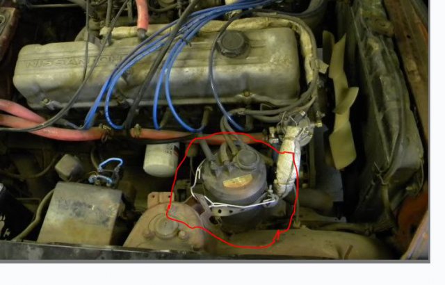

Ghosttanker, thanks a lot for the advice, I was about to get rid of the 280 dizzy, saved the link you gave me and about ready to do it this week, as far as the mechanical fuel pump, yes i still have it... I can't take any good pictures but I attached cell phone quality ones. I really appreciate the help.

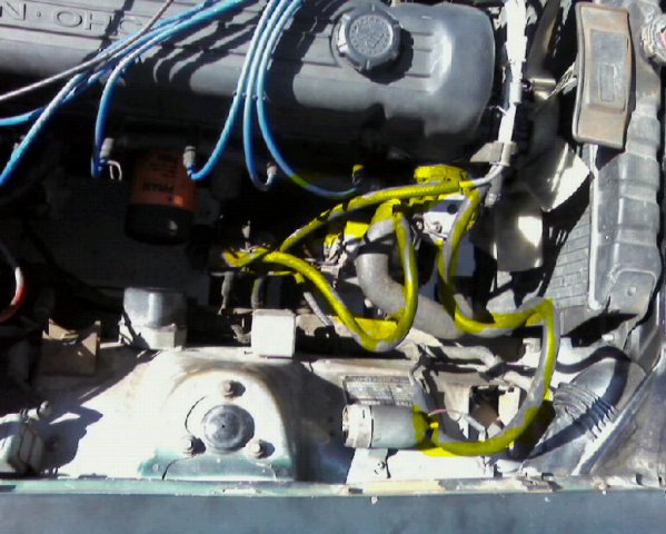

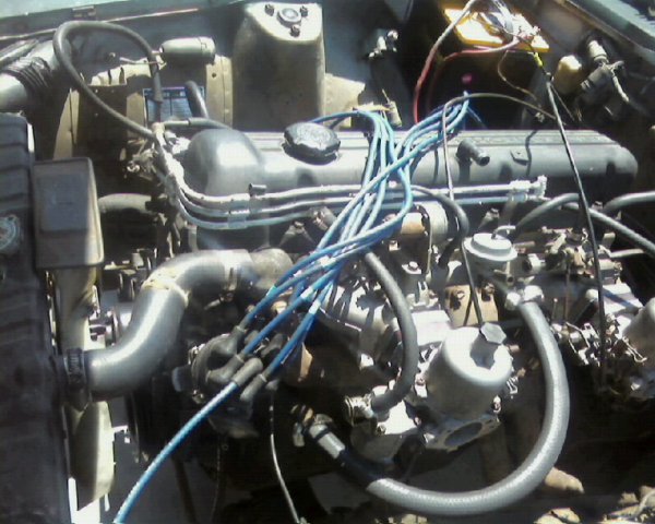

Hello and thank you in advance for the great help people in this virtual community provide. I have an early 1974 260Z with stock L26 and SU's paired with a 5speed trans and 40lbs of bondo. When I first got my car on may 5! it didn't run, it had been that way for 5+ years.... My first problem was the distributor, there was no spark. I looked for a cheap used one but never found it. Ended up buying one for a 280Z that a guy told me would work on mine but it did not...... minus $70 Then I saw an add on craigslist for a 240Z points dizzy and it worked! My car had spark after one month of collecting more spider webs Unfortunately it didn't turn on.... Next step was rebuilding the carbs (my dad's friend did it for me) I then took off the gas tank and emptied it out, upon doing that I noticed some of the hoses in the fuel pump weren't connected where they belong. Fixed that and replaced the fuel filter. Car didn't turn on.... Got a gallon of gas and dipped the gas lines highlighted yellow in the attached picture and car turned on! I could now use some help, aside from buying a new fuel pump what can cause my problems? Gas isn't being fed to the engine.
