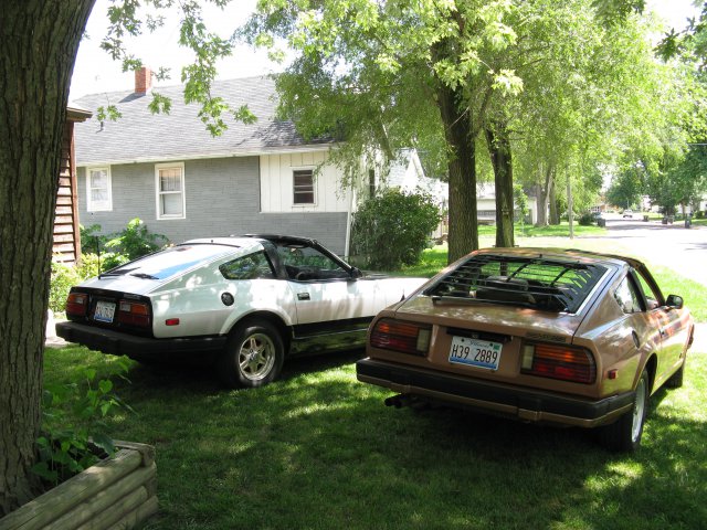

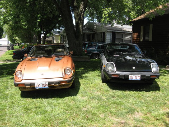

I have two 1982's, unfortunately the distributors are not interchangeable, one is the turbo at the other a 5speed
