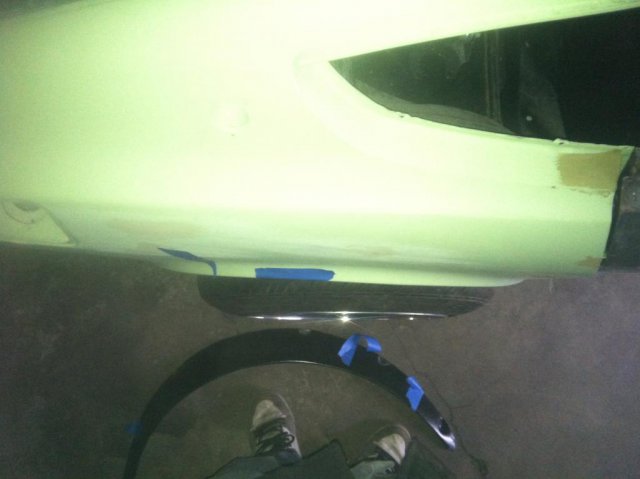

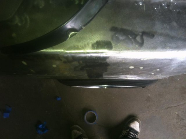

  6. lol. I cut my fenders yesterday, i'm happy with the look. 4.5" and 3.5" lips
  7. The offset is perfect. There is about 3/4" of backspace before my coilovers.
  8. I am painting the fenders with the car, so it's all got to be done at the same time. I am probably going to fiberglass them in at the paint shop, the ebay flares that is.
  9. I can't really wait that long either. I have to have my car at the shop on Saturday. I might use the flares I have and twist them so that the curvature fits the lip and fender. Then I could fill the top seam/gap with body filler. I think that's the plan now.

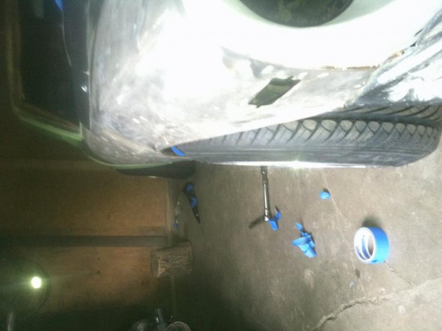

  13. I just finished installing coilovers on shortened strut tubes with new wheels. I was going to use ZG flares, so I bought some cheap ones on Ebay and I guess you get what you pay for. They look terrible and I am not putting them on my car. That got me wondering if I could maybe do without flares and just roll them somehow. My car is going in for paint next Saturday, so I'm hoping to find a solution before then. Here are pics of how the wheels look now. They are 15x9 and 15x10 with 205s and 225s. I should mention that my rear tires are touching the fenders now. I am using Koni struts and they are really short. In cutting and using zg flares, this wouldn't be a problem, but rolling them is probably not going to make enough room.
  14. I did section the rear strut but I only took off about 1.5". I am also using a 1.25" spacer. The problem was those 26" tall tires. I'll look into some of those other tires eventually. Right now I am going to use Kuhmo Ecsta's ASTs all around. They are about $65/ea and H rated. I think they'll do the job fine for now. My Z hasn't been on the road in 3 years, so i'm just looking forward to getting it back to that state. It goes in for paint on the 18th.
