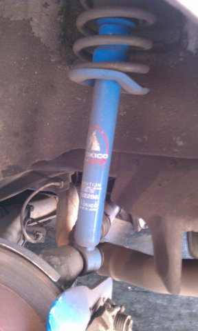

I have ST Springs and Tokico HP "Blues" on my 1979 280ZXR. I just called Suspension Techniques about spring rates for their Sport Springs. They said that they don't list spring rates for the 280ZX, but indicated that they're 10-20% stiffer then stock springs (Stock Saggy Springs?) Anyway, they won't work for my new wheels setup. Have to go with coilovers. ZXR -
This post is in regard to the S13 vs S14 coilover set up for the REAR of a 280ZX. I am new to the coilover world. However, I have read so much and understand the technicals. I am aware of the height difference between the two. However, I cannot find any exact post of anyone anywhere on the web who has actually installed S14 rear coilovers vs S13's. Most people start their posts out talking about the REAR and then end up talking about the FRONTS. What would be nice to see is a post showing someone who has actually installed S13 vs S14 coilovers on a 280ZX with possibly pics. I would like to know what the two look like side by side and if the S14's can be lowered enough to compensate or the S13's raised enough to be able to perform. Or to know if running S13's, what spring rate is best for performance and squatting. Here's my dilemma. I have a 1979 280ZXR. Just bought the ROTA RB's with 235/45/17X9F and 255/40/17X9.5R. So far the fronts fit fine without rubbing the cup in the front utilizing the Techno Toy Tuning RCA's. The rear is where I'm having an issue. I am aware that I will have to roll the fender. However, I am currently running Tokico struts with ST springs all around and in the rear I'm bottoming out. So essentially which coilover would be better to be able to have low enough, but also high enough to clear for performance. PLEASE ADD PICS IF YOU HAVE THEM. Cannot find anyone who has successfully done this conversion completely and hasn't had any problems. I respect and appreciate all feedback, but please don't indicate that this has already been done. Unless you can provide me with a link, so that I can reference it. Because I have searched and searched and cannot come up with anything. Thank you for reading and posting. ZXR

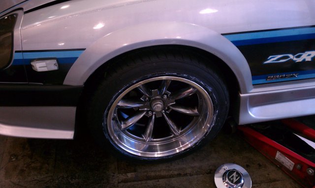

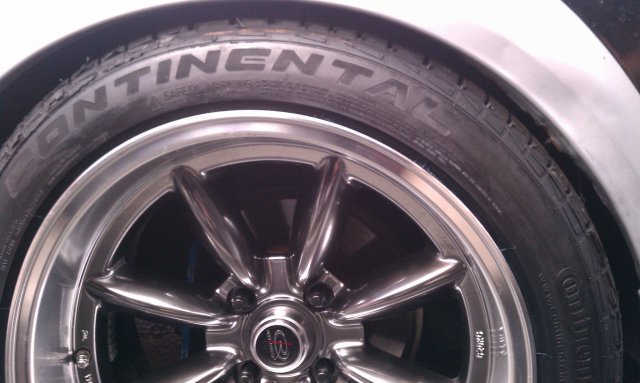

Just took my 1979 Datsun 280ZXR (www.280zxr.com) to America Tires yesterday for the right fitment of tires. I will have to say that on a 1979 with lowered suspension, all you need it the Techno Toy Tuning RCA's (Roll Center Adjusters) in order for the tire not to rub on the spring perch. My ZXR is fitted with Suspension Techniques Springs, Tokico non adjust Struts/Shocks and Suspension Techniques Beefy Sway Bars. I also have my rear A-arms slotted for toe in and toe out. We fitted a 245/45/17 on the front and hadn't any problem with rubbing. Although, I opted for the 235/45/17, because I saw a possibility with fender rub on a bumpy corner and I have the full MSA body kit. In the rear, I thought I would be able to run a 275/40/17, but just as "SlownRusty" indicated I believe the offset for the rear should've actually been 17X9.5 -13 instead of -19 or just reversed from front fitment. After installing the 275, tire stuck out 2" on the outside of the fender with no camber. So honestly, without having coilovers and camber plates on the rear, how "sticky280zx" got a 275 to work, I disagree. I ended up going with the Continental ExtremeContact DW's, 235/45/17 and 255/40/17. After doing extensive research, they are rated #1 tire in the Extreme Summer catagory. http://www.tirerack.com/tires/tires.jsp?tireMake=Continental&tireModel=ExtremeContact+DW Also after calling Racing Lab and inquiring on weight. They indicated that these wheels run roughly 19-20lbs each. So I opted to find a lightweight tire to make up the difference. Rarely does anyone look at the tire weight. Usually only wheel and overall with Wheel and Tire. Rotating Mass is extremely important for gearing and HP. The Continental ExtremeContact DW 235/45/17 weighs 21lbs and the 255/40/17 weighs 25lbs. I compared several different makes and models. I was looking at the Continental's, Nitto NT 555's, Yokohama S Drive and Hankook's Ventus V12 EVO. Also the Continental appears to have the lowest height profile of all of these. I live in the NW. I only drive my Z in the summer months. So I only wanted to tire with Dry performance. Since I drive my Z aggressively, but still wanted them to last a little longer. I've ran the Yokohama AVS ES100's (280AA/A) for years on a 15X8.5" Wheel and swore by them in the DRY. The Continental has a 340AA/A rating. A little higher then what I wanted, but the ratings smashed the competition as with the lower numbers between 280-320. I will update you on actual performance later on, when I tear em up. Please indicate any feedback respectively. Not sure what else to do on the rear except to run coilovers and camber plates. -ZXR Rubbins Racin!

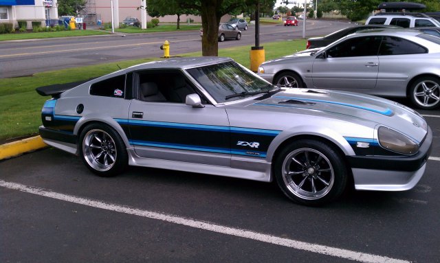

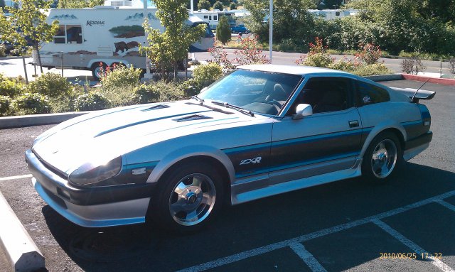

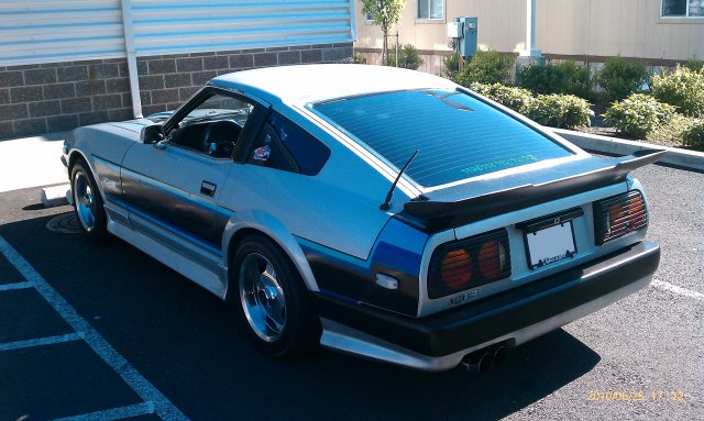

This is my 280ZXR with the original whale tail. I've owned it for 14 yrs. Bought it with 52,000 original miles for $2,500. Have invested over $20 grand.
