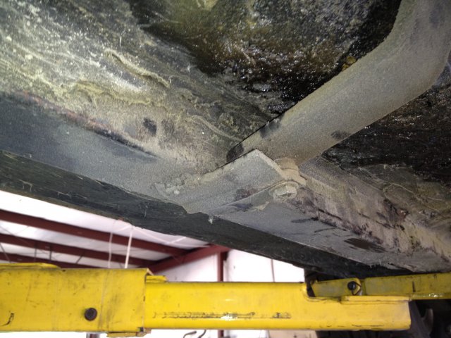

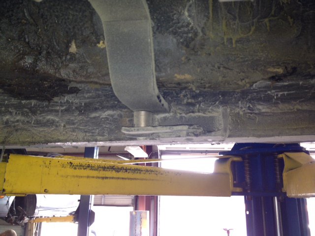

When I get back to my shop in the morning I'll take more pics. As for the bottom of the car yea it's pretty bad the guy who built it put silicone on everything with a butter knife it looks like lol. And it's covered in dust cause it was in a restoration shop for 20 months that did a horrible job so I'm in rescue mode trying to fix two horrible jobs on this car

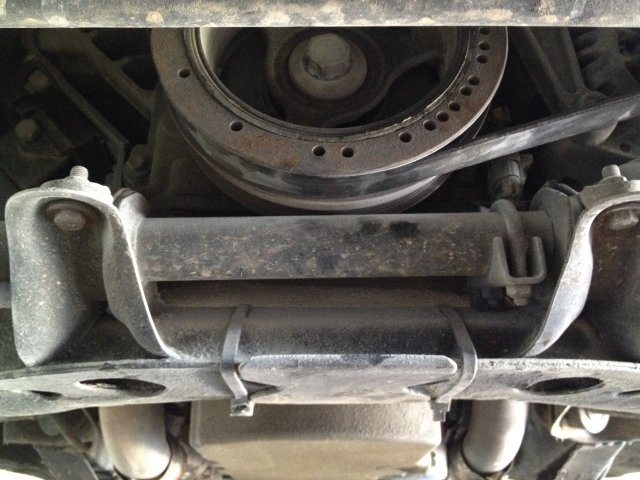

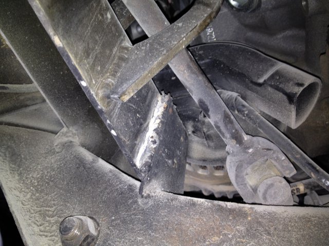

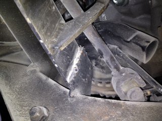

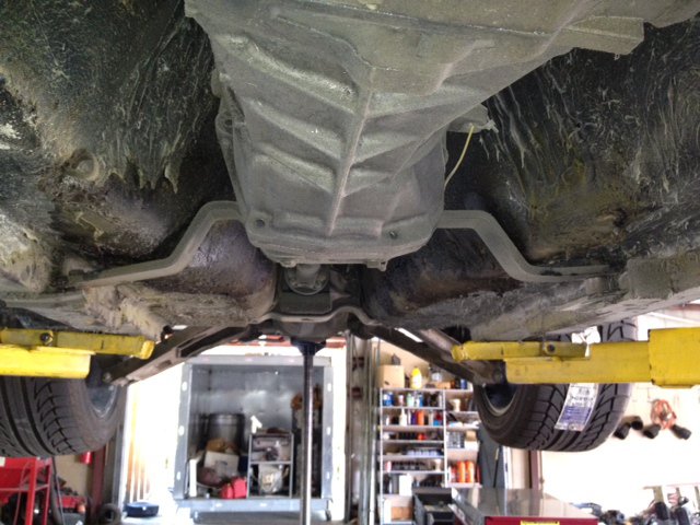

i have this car at my shop that im working on and i just need some quick info from some one who has completed the swap. the engine crank pulley is really close to the steering rack and the alternator is hitting the mount on the engine cradle. the customer purchased this car with the motor already installed and its a ls3 which i dunno if thats the reason its so close and hitting, but i thought it was the same size as the ls1 but i could be wrong. The person who did the install welded the mount kit which was suppose to be direct bolt in and did a hack job on the transmission cross member so im thinking thats the problem so any help or info would be nice. smaller pics in post 5
