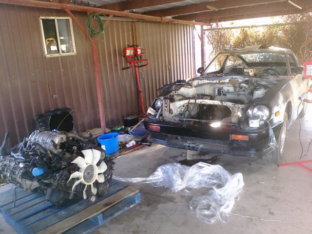

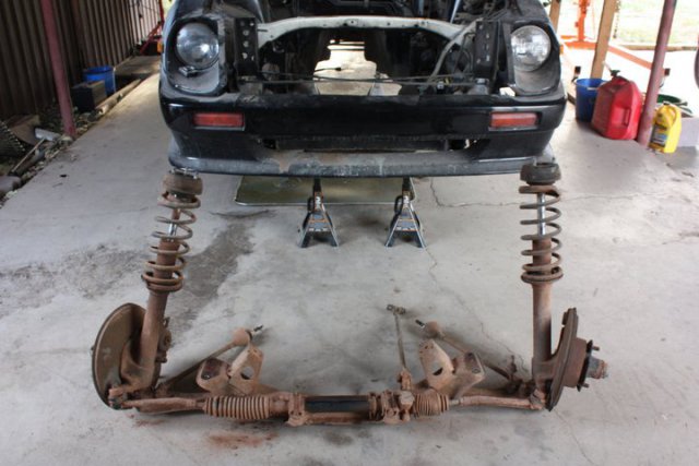

  10. January I purchased my '79 280ZX for 700 bucks shortly after getting it home we pulled the L28 out and started thinking of engine choices. After many ideas were thrown around I decided I would go with the RB25DET and so the money pit begins. A loan and ebay visit later the motor was sitting at my house. The loan covered engine purchase, oil pan, greddy style intake, and engine mount kit from mckinney motor sports. Now to switch gears a bit, with limited adjustable suspension choices for the S130 as well as brakes to handle stopping the RB, I decided to do something different and swap subframes from a S30 chassis. Surprisingly there isnt much difference between the subframe areas of the S130 and the S30, after a visit to the junk yard I had the subframes from a 240Z. Here is a picture of the front. To further explain the need for the swap, I went to ArizonaZcar.com and saw that they had a fully adjustable control arms, shock/spring assemblies and the brakes I was looking for. My over all goal is to build a RB powered S130 that goes around corners. The rear A arm set up for the S30 will have to be partially fabbed to make it work and after a few measurements I believe that this swap will work very well. The front subframe initial fit went well the mount points for the subrame will have to be cut and a wider plate will be welded in to line up with the holes from the frame. I will throw front fitment pictures up tomorrow. I am open to any advice on the build over all , I will keep this thread updated every few weeks.

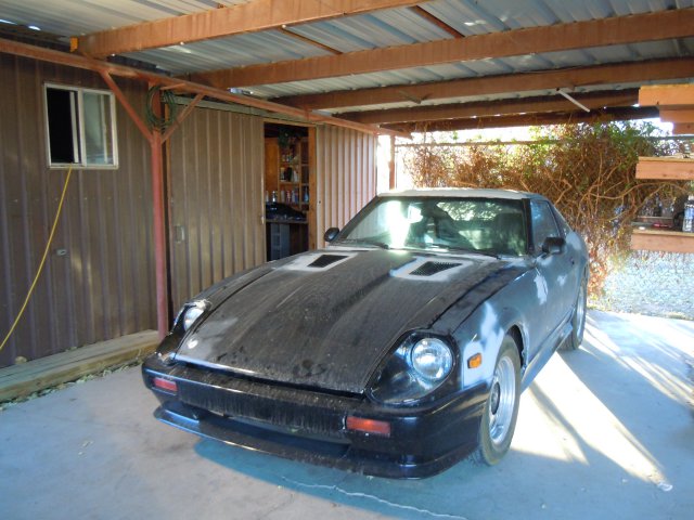

  12. 86murdoc
    The ZX after I got it home.
