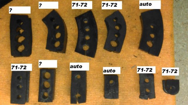

  5. hello all I need help with the id of fuel line and brake line rubber insulators. The three insulators in question have a ? above them. I need to know what year or if they even go on a 240z, maybe a 73? They seem to be for larger fuel and return lines than on 71 and 72 240z. maybe a 260z or later since both the return and fuel line are the same size? 2nd top left is a tunnel insulator but not sure the year or model( 99.9% sure its a 260z since same size fuel and return lines)?, and the 1st top left is the free floating insulator under tunnel near rear end , not sure on the year or model(99.9% sure its a 260z since same size fuel and return lines ) 2nd bottom left with 3 holes looks like it is a 260z (99.9% sure its a 260z since same size fuel and return lines) anyone with a 260z willing to let me know if they are on your car? any help or input would be a great help

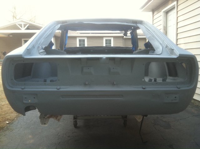

  15. I purchased mine online, I was looking at your pictures and your is rusted out exactly underneath just like mine. I purchased a 18" Bending Brake from Harbor Freight for $35 and bent new metal and welded in new parts. Then welded in new sill plate, it fits really good and also looks factory, you will have to drill the holes for rear taillight body panels and license plate light.

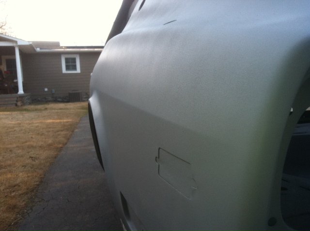

  16. epoxy primer on all bare metal..no I used very little body filler, only fixing the low spots, then 2k high build primer which will cover and fill scratch marks on body plus small problem areas. here is a pic of my hatch sill plate
  17. I sprayed the entire bare metal car with epoxy primer, then did my body work, then sprayed it with 3 coats of 2k high build primer, guide coated the 2k high build with 180 and 320 dry. Then shot 3 more coats of 2k high build and wet sanded with 400 and now doing 600 to remove orange peel in the primer. Then I will spray a 2k sealer right before I paint and let it flash, then I will paint the car and then wet sand with 1500-2000 to remove orange peel and trash... I have been working on my body for almost a year now...
  18. nice project...I am just a little ahead of you on my 71. All my body work is now done and I am now wet sanding with 600. I replaced the roof and leaded in the joint just like the factory did, repaired rust on floor pans, cut out all rust and also did the rear hatch decking, hit me up if you have any questions..
