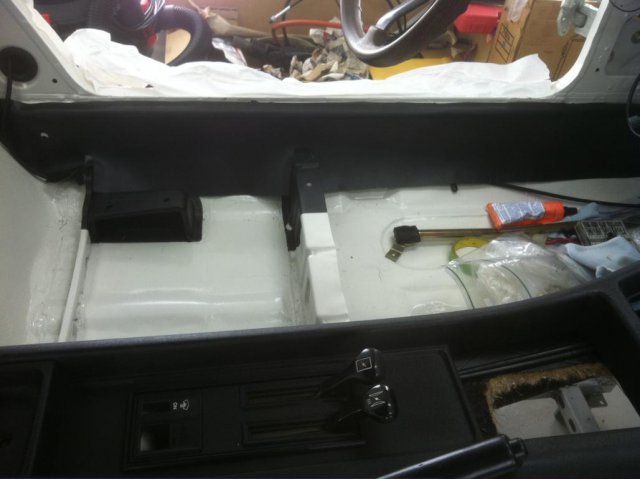

    Been a while since I updated my build and I am still working on small details of the car. Suspension and brakes are done and some of the interior is in back in the car. Made new main wiring harness rubber tad holders Dash in car now.

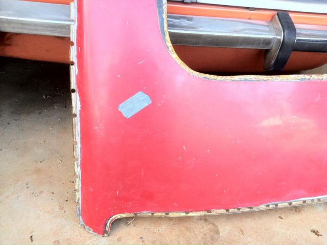

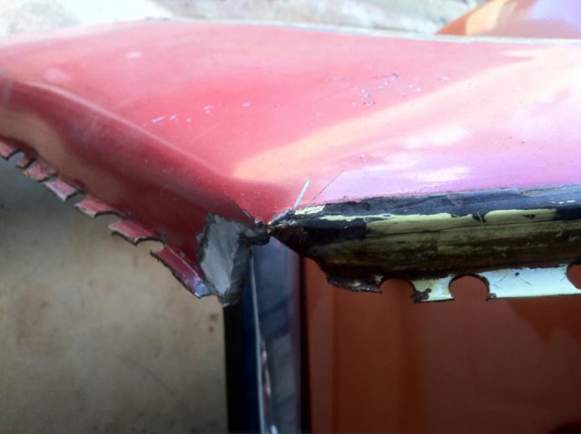

    I did the original roof from the top and donor from the bottom. There is about 93-96 spot welds per roof, if I remember correctly. I used a spotweld remover for both skins. Steve

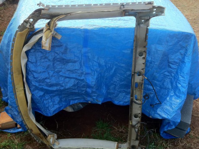

    a few pics of when I did my roof. Red original with sunroof Gold is the donor roof.

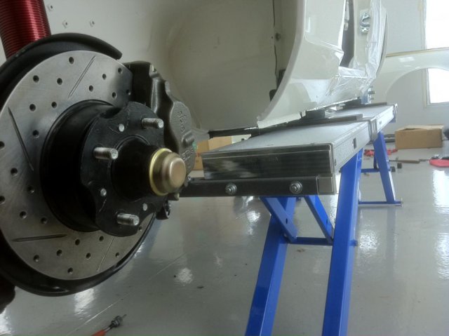

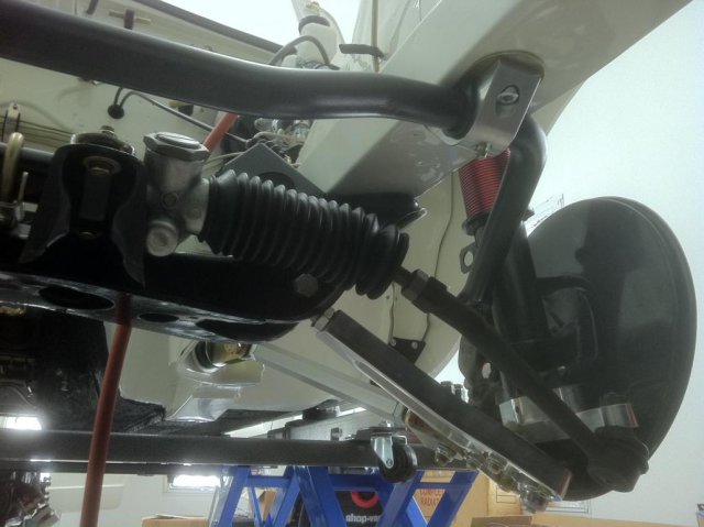

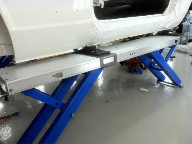

    The ezcarlift was delivered yesterday via Fedex. It was shipped in two very well packed boxes, each weighing 75 pounds each. The lift was very easy to assemble with nice instructions, with pictures. All I can say is WOW, this lift is very nice and is put together very well. The lift is very smooth and very stable, I pushed on the car and it did not move. z owners will need to order the hockey pucks. A few pictures of the lift at about 1/2 the lifting height. I have the lift in a position right now, so I can install the R200LSD, NEW 1" Suspension Techniques Front Swaybar

    ordered a ezcarlfit and new tires, so I can get the car off the dolly. Then I can install the Rebello 3.2L.

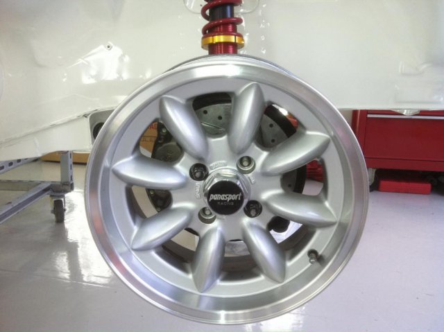

    Thanks, watching your project got me back moving again on mine. I was pumped watching your Rebello engine video. 16" Panasports.....

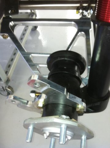

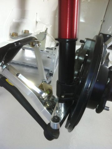

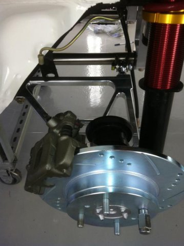

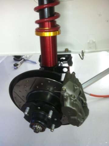

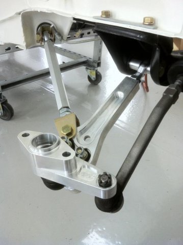

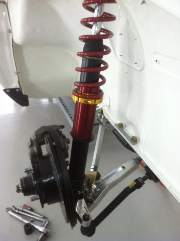

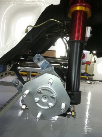

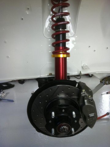

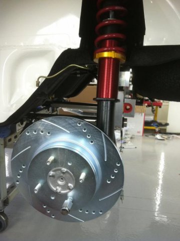

    Rears today with Arizona Z car rear end, coilovers and Tokico Illuminas. Refurbished 280z stub axles with 280zx turbo companion flange adapters. New bearings, seals, rotors, calipers and plated hardware.
