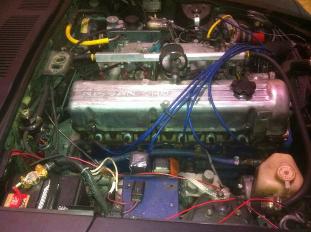

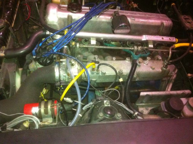

I have a EM-5D which does not control my ignition. From my understanding the SDS does not allow maps ( or the one that I have does not), its basically one setting for your whole powerband, and with mysetup its not working. Racing Greed told me that its either I have good cruising AFR or WOT afrs; its either one or the other. If I upgrade to SDS coils, I will not be able to properly tune my ITB's because SDS does not support tuning by TPS value? Knocking at lower RPMs and pinging was also heard. Racing Greed's answer is the exact same answer that another reputable tuner shop here in BC has told me last year, when I had the car dyno'd. Racing Greed also told me if I want to have a good tune with my ITB's that the Haltech will allow me to tune via TPS value and Alpha N tuning? Which my SDS cannot do, according to them. I am still in the process of getting the rest of the info that you guys requested. When you guys look at my AFR's from that dyno pull what does it tell you? My AFR's are no where near you guys say they have to be at higher RPM..so how do I correct this? It seems that I need a standalone with adjustability to add or remove fuel and spark at certian RPMS to tune out this and correct this? I am seeing AFR's between 9 and 10 at higher RPM....
I am using a stock distributor with a MSD blaster coil How would I go about tuning the fuel maps? Racing Greed told me that with my setup, I can either have cruisng setup or WOT, not both. Currently my cruising is good, but when WOT, my AFR's are way too high. I am trying to figure this out and have come here to try and seek some answers. Please stop posting how I need more info when I have posted that I am getting all the info requested and and posting it as I find out. I appreciate the help, but please read what I have posted before telling me that you need more info. For the fifth time, I am getting all the info that people have requested on the site!!!!!
hmm well this is the second tuning shop that has told me this so is it just them? or are they right? they are telling me my SDS cannot control my ignition. both tuning shops have told me the exact same thing! frustrating? **** yes i just spoke with SDS, and I can convert my car to coil ignition system and control my ignition? my current sds has no system to modify my ignition.
i am not sure that I have a stroker,, I was told it was one by the PO. I am going to find out by the weeks end ! If you read my post, you would have found out that I attempted to get it tuned, but with my SDS the tuner was unable to tune my ignition. With my current setup, I am unable to properly tune it.
had the car dynod today...on 94 octane car made 150 @ wheels, roughly 225 at crank....on a mustang dyno. here in BC @ racing greed., so I have a N42 head,, I can see the stamp on the head. motor was knocking at idle/ low rpm but seems to go away as rpms go higher.. Head is being pulled to inspect pistons and pull a rod and measure. Inspecting head to see just how good the port and polish job is! Oil pan is being pulled to fix leak and install new gasket, we will be inspecting crank to see any stamping to determine what I have. We are going to measure cams and determine what cams are in the head. Injectors are being sent out to test flow and determine CC. Still have to check timing. Tuning shop reccomends I dump the sds and get a haltech so they can tweak my ignition, they told me with current SDS they have no way to change ignition and properly tune car. As i mentioned before my AFR's are way too high. Apparently at cruising speed everything is good, but at WOT I am running so rich that I am depleating all the oil in my cylinders and risk running them dry? once we pull the head and inspect crank I'll report back what I have found and what my stroker is comprised of... I am all ears for comments and your views on everything...
