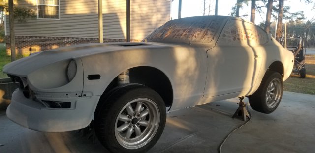

  3. Finally got some paint on my 260z! Its been a 3yr total restoration.. i also did sti diff custom halfsafts..more. more..lol. i took pictures along the way..if you guys would like a break down let me know..
