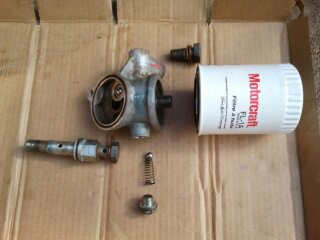

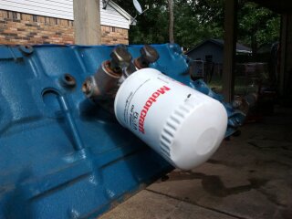

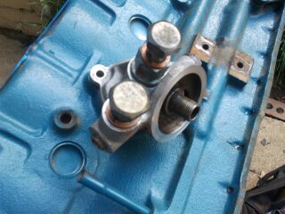

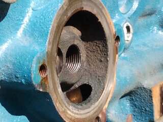

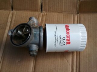

  4. Hello, I do no want to use my engine oil cooler. I want to install my oil filter to the block. I have searched and cannot find an answer to my problem. The threads to the block are M18 X 1.50 the threads to the oil filter are 3/4 X 16. When you unscrew the sandwich adapter plate from the block you are left with a female M18 X 1.50 opening. This is where I want to install my oil filter. There is no nipple when you unscrew this adapter plate. Where can I find an M18 X 1.50 to 3/4 X 16 adapter? I think the metric threads on the block will match up to an 02 sensor. Can I use the adapter plate with modifications? Here are some pictures of the plate and with the plate apart. kenny.
