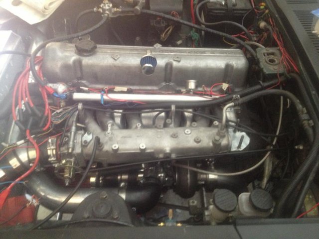

Ive finally got my 280z turbo up and running and Im extremely pleased with how its turned out, thanks to the help of some guys on here. Even though Ive wanted to throw it off a cliff or two, I think it is time for the next step or at least start thinking about it. But what to do next? Exterior, interior, MOAR performance!?!?!? What have you guys done?

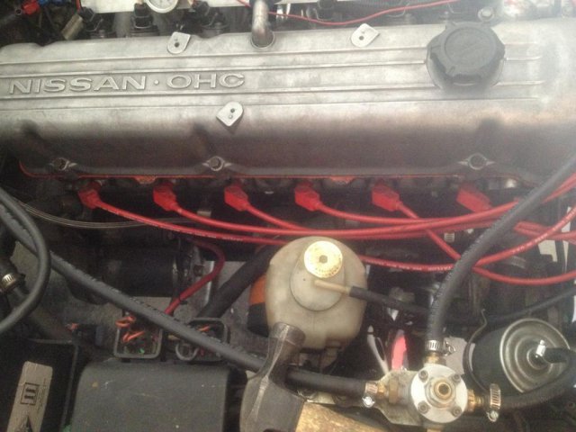

Sooooooo I went to pick and pull and grabbed a charcoal canister from a geo and hooked it up. Low and behold the car ran pretty good. I ran the car for an hour and there was very little to no change in fuel pressure.... And this test had about a quarter tank of gas or a little bit less
Thanks tony for the response, the tank was almost full during both of the pump tests
Alright Ive done a couple tests since I last posted (some suggestions from guys at zcar.com). I tested the pump by itself and with the car running. I was also advised to turn my pressure down from 60-42(3bar) Pump by itself: I ran the pump for 30 minutes and there was no fuel pressure loss. I touched the pump while it was running and it wasnt even warm. With car running: The pressure started dropping after about 17-20 minutes-ish. I let the car run until the car started to lean out and run badly, which was around 45min, so i shut it off. The pump during this test was still just as cool as the solo pump test. Me and my massive car knowledge has no idea what this means. Thanks again for your input, it's helping narrow down the problem.

Ya Reno NV. So its basically vapor locking? do you have any fuel pump suggestions. Could it be that my fuel pressure regulator is bad (doubt that it is due to the car running fine when its cold but who knows)
Ya I have done that. The pressure goes back up when I pinch the return line

I have a 77 280z that i turbo-ed and Im having some issues with the fuel pressure and idk what the problem is. Ive been attempting to get my car dyno tuned but for some reason the fuel pressure drops from 60psi to 40 and then after a few it eventually drops to 20. I originally thought that it was a clogged fuel filter because when I attempted to get it dyno tuned a week ago the car ran out of gas on the dyno. So i got it towed home and bought a new filter to see if that was the problem and it seemed to have fixed it. So today I had another appointment to finish getting it tuned but the same thing happened. So both times it starts fine gets to the shop (approximate 11 miles) but after about 30min-hour or so it just starts dropping. I dont know if the fuel pumps just not working right at that point like if its getting too hot to work or if it is something different altogether. The car has a fuel pump from summit racing (cant remember off the top of my head which one), Mallory fuel pressure regulator, summit racing fuel pressure gauge and an aluminum fuel rail. I'll try and answer any questions to the best of my ability. Thank you for any help, Austin

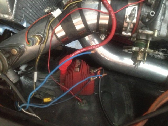

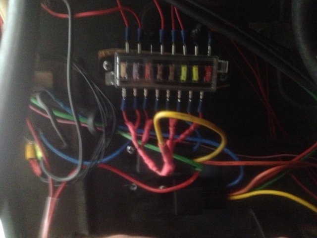

Thanks for the responses. Ill have to go take a peak at some of those wires. Lazeum: The belt is fine, i looked at that as well. When I tested the battery after i re-installed everything we did rev it a bit and it did go up from 12.32 to 12.48-ish. Ill also take a peek at the voltage regulator thats behind the fuse-able links I was thinking about the fuse-able links myself but there a bit of an enigma to me. There's 3 red wires and 1 black one. I read somewhere that the black wire was the one that passed the power throughout the engine. I was thinking of doing this to get rid of the fuses http://atlanticz.ca/zclub/techtips/fusiblelinks/index.html.
Hello I have just got my 77 280z running a few days ago after its been sitting for about a year and a half (Turbo-ing it). Since it sat so long i had bought a new Altima Import 60 AMP alternator and Super Start battery (700CCA) from Orileys near the end of the build. Towards the end of the build there has been a lot of starting and stopping of the car so i kept it hooked to a charger most of the time. After i got the car tuned a little bit (about a few months ago) my clutch started to slip and I broke a bolt on the water pump....... So i took the entire engine out and redid the timing chain and all that jazz since i was already in there. Got it all back together last week and got the car started a few days ago. I started driving around a bit to break in the clutch and the car started two act a little weird. Yesterday I had driven about 1 mile away from my house to pick up some chinese and i couldnt get it to start, the battery was just too dead. I had to get a jump from a guy that worked there and the car died again while i was driving home (luckily it was downhill so i just coasted home). So today i bought a volt meter and the battery was about 11.32v when the car was off and 12.23 with the car on. So I took the alternator and battery back to Orileys and had them tested. They both passed. So when i got home i tested the battery and it was at 12.6v. I re-installed everything and turned on the car to see if i had hooked everything up correctly and then turned it off. I rechecked the battery and it was at 12.48v, which i though was a little odd. So i checked it with the car running and it went DOWN to 12.32v...... then i rechecked the volts with the car off and it went back to 12.48-50 Im not very knowledgeable when it comes to this kind of stuff but isnt the voltage supposed to go up with the car on? like to the 13-14ish range? If anyone has any input, it would be greatly appreciated. Austin.
