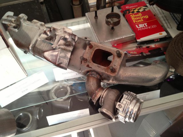

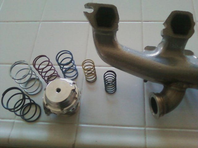

Heere's the welded external wastegate. Also Im having an issue with my steering being stiff. I replaced the busings, the car is off the ground without tires on and it feels like it is on the ground with the tires on haha if that makes sense. Any help is appreciated.
