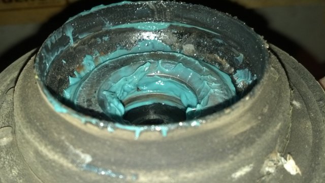

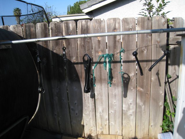

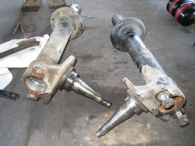

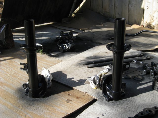

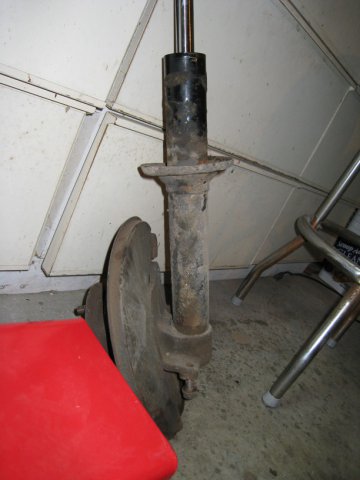

	While swapping strut cartridges i came to one that seamed to be welded in, it was so tight. I was just about to get the drill, to put a hole in the bottom so i could punch the cartridge out. Then i noticed that the right front strut was bent (same side that had the bent strut rod). The mount was also impregnated and imposable to put back on the car. So in 8 days i should have some new ones.(the 280z ones are even worse) I grabbed a strut from the 280z and stripped it down and cleaned both of them up. I use industrial strength simple grean. Its bio degratable and very very strong. I do 25% simple g and 75% water for most things. If its really grimy ill do a 50-50 split. Just be careful with soaking stuff in a strong mix. I soaked some hardware over night one time and by morning it had eaten of the finish. Today i got a lot of painting done. It was mid 80's and 8% humidity in sunny San Diego making the paint dry so fast that i got about 8 coats done today. the new master too

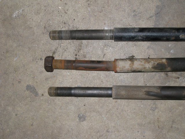

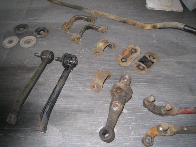

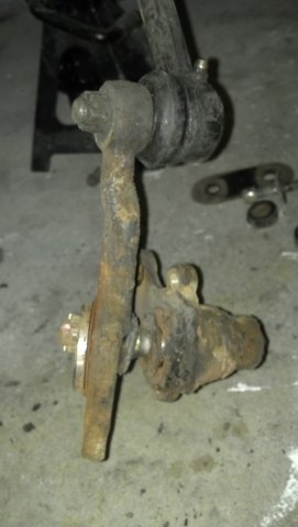

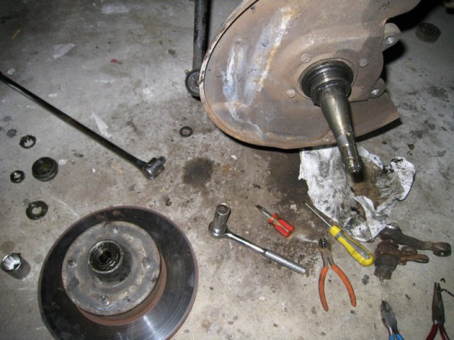

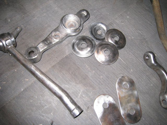

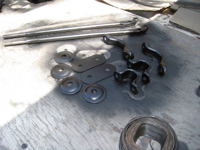

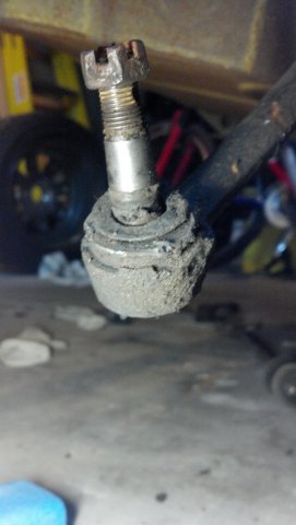

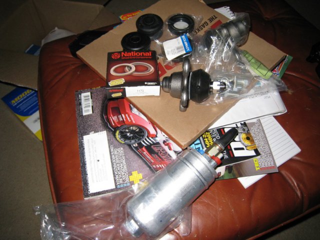

	Another box of goodies After i got off work i spent my evening going through my front suspension components. I started checking for damage and cleaning them up for paint. This is after the converter. It hardens into a blackish purple coating that can be sanded smooth then sprayed over. The brush guard needs another coat since it had thicker rust. It should look good soon though. Going through the suspension pieces i noticed that one of the strut-rods was bent at the top(middle). So grabbed one off my 280 parts car to switch it out. Getting the junked 280z is like having a salvage yard out back, i love it! Invested in some electric tools today that made cleaning metal child's play! Before: After: It started to get to late to run the tools so i called it a night. I have the next couple of days off so look out for more post soon.

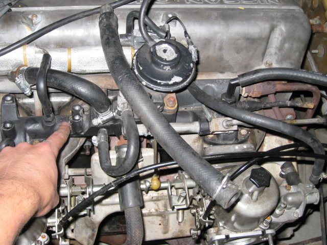

	okay great so i dont need a balance tube? My plan for the linkage is to make a new bracket that mounts off the front intake runner bolts, where the old balance rail was. Ill post the pictures if i do go through with this. im just hesitant because i dont know if the booster vacuum would effect the rear carb.
	Hey so as you can see the black smog/balance tube has been hacked and chopped (its a junk yard build). My plan is to take off the rail completely and cap off the intake runners leaving only the booster vacuum hose on the rear intake runner. Then attach the crank case hose to the intake filter housing and plug all the exhaust manifold holes. Would this work or do i need to weld a tube connecting the two runners?
