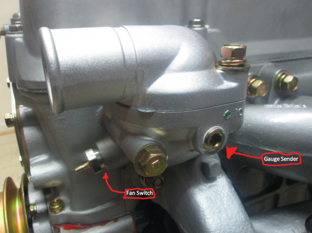

What do you mean by bypasses? I'll attach a picture showing where the fan switch and gauge sender are tapped in.
The fans are blowing in the right direction, the temperature controlled fan is a "puller" and the switched one is a "pusher", the idea being that in most conditions I'd want a puller fan but in traffic a pusher might help too. I've not tried running the switch fan with the engine cold, mostly because it already takes so long to warm up. I'm curious as to what your though process is here? I'll give it a shot.
Here's a picture of how I have my thermostat housing set up. Note that this is not my picture or my engine, just a representation of how I have it set up.

I think the sender is designed to be immersed in coolant, but I think with the adapter only the tip of the sender will be fully immersed. I was thinking maybe an air bubble is trapped in there, but I've heard of other people running the same setup with no problems and I don't have any other symptoms of a cooling system that needs to be bled really but I think this could be the case. Another possibility is that the adapter allows for some pocket of coolant around the sender that isn't moving even when the thermostat opens and is staying cooler, but that seems really far-fetched and the pocket would heat up to it's surrounding temperatures pretty quick.

Using an Autometer temperature gauge with the sender in the thermostat housing on the end of a BSPT to NPT adapter. I don't have an infrared thermometer to confirm the readings with but I should probably get one.
