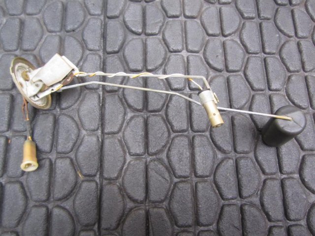

  7. Hi,i,m trying to find 2 of the above fuel tank sender units.This is the type that has the basic float,but also has a low fuel light probe. would need to be shipped to New Zealand,please view photos
