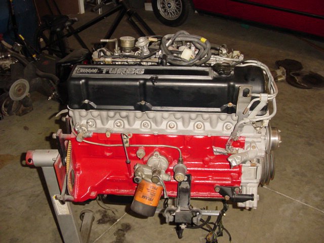

Put the motor in this weekend . Clutch is on its way. Hopefully ill have the rest of the driveline in by this weekend.Heres some more pictures -

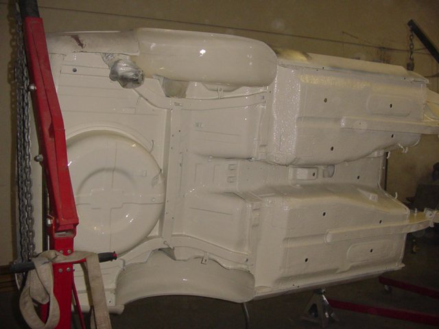

I just had the bottom tub undercoated with reflex rubberized bedliner undercoating and then painted with the factory color 71 240z white -

	Heres some pictures of my 240z I have just finished painting the bottom white but the pictures shown are with it hanging from my redneck roticery
