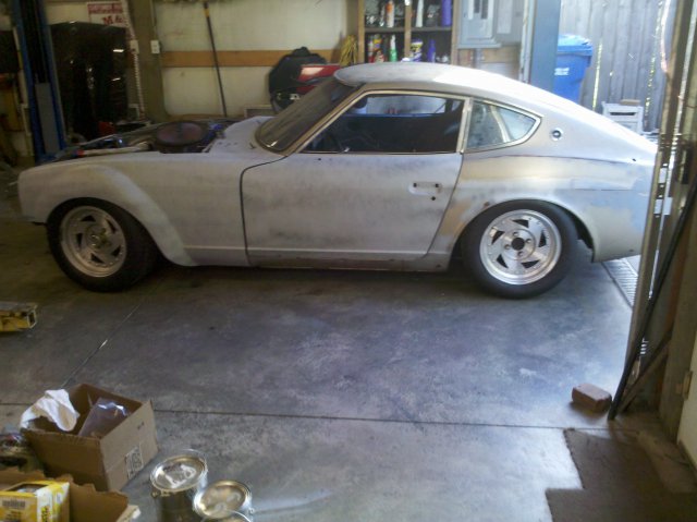

Thats awesome you guys. I love hearing more about v8 datsuns. As you can see from my pics that im running molded in fender flares so I will be able to put so real rubber underneath the car. I also forgot to mention that I have a 3000 stall in the tranny as well. My wheel and tire combo that I will be getting is the rota rb 17x9.5 rear and 17x9 front and will be running 255/40/17 fronts and 275/40/17 rear unless I can fit something wider on it like 295/35/17 or something. Not to sure yet. But I really want to get a 15x10 rim or atleast 15x8 and run some 26x10 slicks and I really want to get a set of mickey thompsons wrinkle walls to gain as much traction as possible. I really wish that I could make enough power to pop the front wheels up but doubt that will happen with my current setup. Thanks for the input so far and love hearing what other enthusiasts are doing as well. I really don't wanna stray to far from the 3.55 gears when I do get my lsd rearend, knowing mines a street/strip car. Dans toy what ford rear end are you running in your car right now? And also that means you don't have the independent rear suspension anymore? I spent way to much on all my suspension to put a straight axle under it and really like the cornering ability of my independent rearend like it is that I wouldn't want to change it out. Also once my car is on the road I will definetly go to a weigh station and see what it pulls down weight wise with me in it and pretty much in race trim. Also turbo meister what wheels were you running to get a 12" wide slick under your car and were you still running datsun rearend and "datsun rims" thanks guys -

Hello I have a 1977 280z that I've been building as a show and go car. I have a 355 sbc with all forged internally balanced internals, flat top pistons with 10:6:1 compression ratio and a comp cams magnum mechanical cam 2500-6500 rpm 248/248@.050 dur and. 525/.525 lift, high volume oil pump and weiand action plus water pump and edelbrock e-tec 200cc heads with some port/polish work and comp cams pro magnum 1.6 roller rockers ($330 a set) victor jr single plane intake manifold and holley 770cfm street avenger carb. Msd street fire hei distributor and mallory nitrous 6al ignition box and taylor 8mm pro wires. Also has a nos cheater setup for an added 100-250hp shot (hence the mallory nitrous ignition box for retarding the timing) and bottle heater w/ pressure regulator and purge system. Also has electric fans and electric fuel pump with my fuel cell and no power steering or anything. The only thing the motor powers is the water pump and alternator to free up as much hp as possible. All hooked up to a th400 tranny and a r200 3.55 geared posi rearend. All new urethane bushings and bigger sway bars and tokico illumina adjustable mr2 struts in front and 240z struts out back with ground control coilovers all around and toyota front brakes and steel braided brake lines. Im not sure what kind of power this setup will make me cause I haven't got it on the dyno yet but im hoping for 450+ on motor and I will put 100 shot behind it most of the time and once in awhile the 150-175 and just for kicks I have to do the 250 shot once. I wanna do the 250shot on the dyno once also to have a huge dyno sheet in the 650+hp range lol. But my main question for all you v8 z car guys is what kind of motor setup are you guys running and how much power are you putting down and when you have been to the track what kind of times have you put down? Ive done et calculators and im pretty sure im not gonna be doing high 10s with 450hp. But i really wanna get an idea of what other guys are running with their setups and hp. Thanks everyone for the feed back and feel free to post pics. Soon as i can i will
