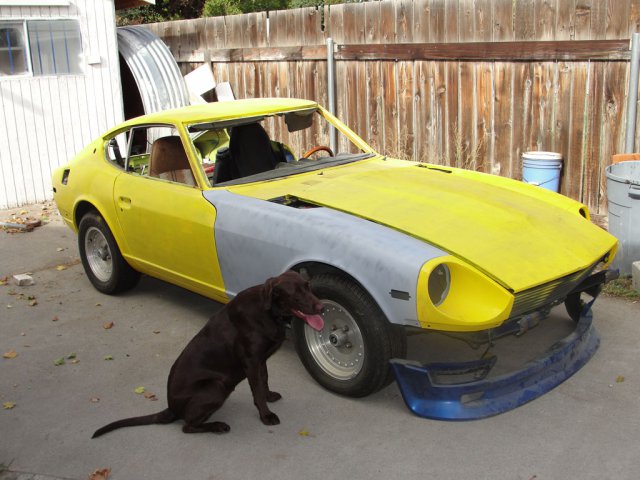

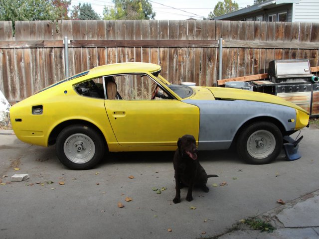

  4. It has been a long time since an update as I've had a ton of stuff going on with both work and graduate school. In any case, I'm in the process of figuring out how to make the new throttle body work. There is an air passage on the '98 version that does not exist on the 2000 and later TB's so I'm trying to figure out if it can just be plugged/ignored, or if I am going to need to do some machining on the intake plenum. I've been tossing around the idea of using all of the original equipment (throttle by wire) instead, as I still have all of the original parts. I will be able to use this set up and get the car running. Then, when I break down the engine for the turbo rebuild, I can figure out how to integrate the mechanical throttle body. Of the time that I've spent recently on the Z, the most that I've done is finish stripping out the interior. Now I'm at the point where I just need to patch the frame rail under the passenger's seat and then fabricate some seat mounts. Speaking of frame rails, does anyone reading this have any suggestions on the best/most efficient way to strip the crap off of the undercarriage?!
  5. Funny you should mention that, Cockerstar. The Fiero picture was taken in Idaho Falls, ID and my Z pictures were taken here in Richland (at my ABC duplex). You'd be surprised how similar Idaho Falls and Richland are both in geography and demographic. In any case, I am definitely in need of a welder. After scraping a good portion of the undercoating off, I found the first spot of rust on the passenger frame rail. The plan is to patch it asap so that I can install new passenger seat mounts (they were removed before I acquired the car) and seal the interior. logrIl, I'll most certainly take you up on that. I've only been a handful of times, but I'm really hoping to get into it once I get my car done. Today, I should be receiving my new intake throttle body. The original TB is TBW (throttle-by-wire). Apparently, 1999 and up Camaros had an electronic throttle body governed by a sensor on the accelerator. After discussing this with a buddy on the Fiero forum, I was told that it would be a nightmare if I wanted to retain the TBW with a turbo setup. I was told that it would be MUCH easier to get the cable driven throttle body and run a non TBW ECU. So that is the state of things. I'll have the throttle body on this evening and then I'll start the eBay/Craigslist search for a new ECU. Edit: spelling... Edit 2: Format

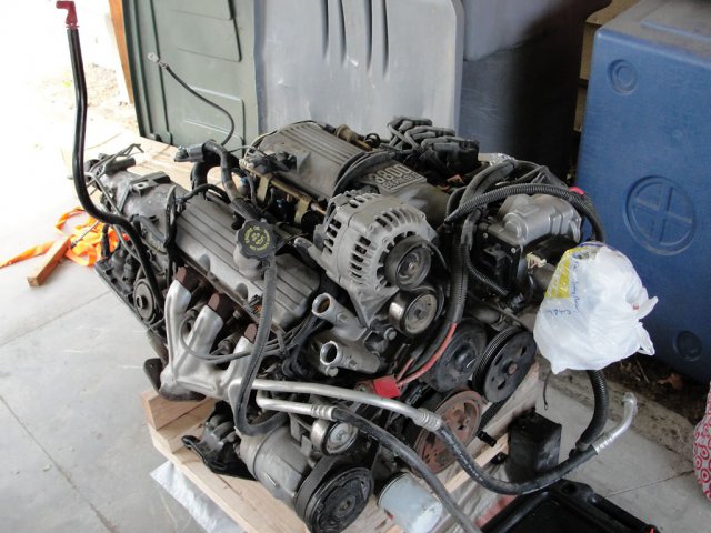

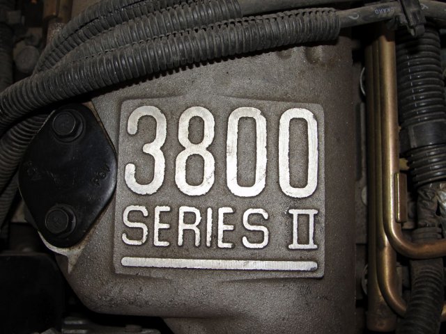

  10. I would like to start a thread (and I may shortly, I've got PLENTY of initial pictures). As for mine, I picked up a series II engine and transmission from a 2002 Camaro (the guy I bought it from told me that it only had 30k miles on it). I've already sold the transmission, since it was a 700R4 and I want the T-5 or the T-56. Since the engine is an f-body motor, it has the electronic throttle body, so I'm going to have to find a cable throttle body. I've read many places that the Cadillac NorthStar throttle body works exceptionally well as long as you calibrate your PCM with the N* MAF sensor. I'll be running stock heads (N/A) and intake, with plans for a turbo. As for the motor mounts, I'm having my father fabricate a custom cross memeber that I'll use to attach the stock Camaro motor mounts, that way I'll still be able to use OEM mounts is I ever need to replace them. I just need to fit the engine, take some dimensions, and make the CAD drawing for the cross member. It will be nice doing this install parallel to yours, Calico. You can be sure that I'll be pining you with all sorts of questions.
  11. Have you started a thread for it? I'm starting this as well, I just bought a Series II tonight!
