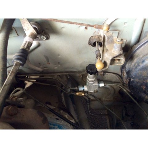

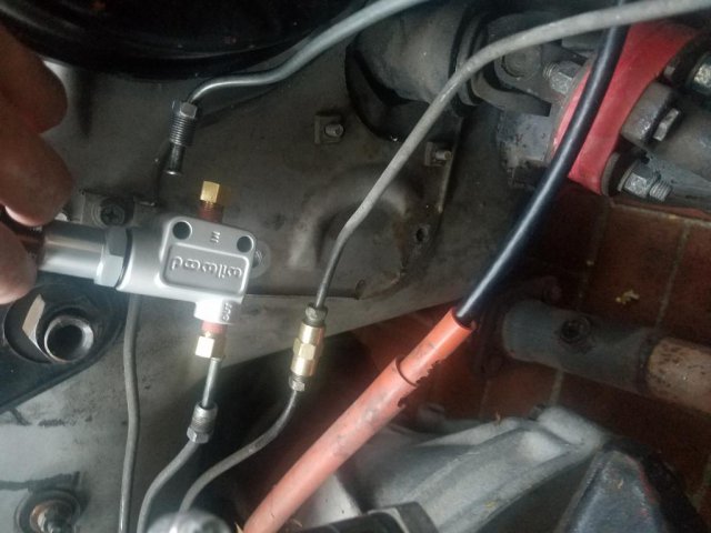

this is a rough mockup of what I want to install. the top photo is a picture of my engine bay, the bottom is how I want it installed. this is where I am a bit confused, the stock lines in my car are perfectly suitable for an install, the brass fittings on the willwood prop valve are just not 10m so I cannot use the lines. -

this proportioning valve is still causing issues since I don't want to make custom lines, (dont have the tools). I've decided to take a different approach. instead I plan on buying two 10m male to m10 female invertes flare adapters so I can use my stock brake lines and install it in the engine bay on the firewall. anyone have any experience with this approach and know if it is a viable solution https://m.summitracing.com/parts/aaf-all50120?seid=srese1&cm_mmc=pla-google-_-shopping-_-srese1-_-allstar-performance&gclid=CKmMvKee6dQCFQ-OfgodRIsC4A these are the adapters I will be buying to screw into my willwood proportioning valve -
