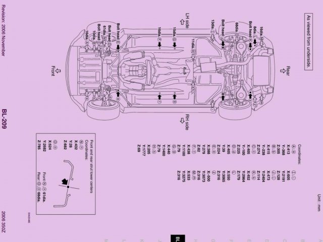

It is implied by some articles that the 350Z front suspension (with 14 patents) is carried by a single front subframe. But without verification, I'm at a loss as to how to proceed. http://auto.howstuffworks.com/nissan-350z-design2.htm "There was just one level of suspension tuning for the 350Z, although both 17-inch and 18-inch wheel/tire packages were offered. The front suspension was carried in a subframe mounted directly to the body structure." I found a source of used parts that has a pretty good database for comparison. It shows the front and rear subframes for all kinds of vehicles (including 350Z, 370Z, SC400 are in stock at the moment) http://www.slidegood.com/part-categories/suspension/subframe-and-crossmember.html?body_type=84&dir=desc&mode=list&order=price I went ahead and called them. I spoke to John which was really informative. He's under the impression that only the front "crossbar" and "engine cradle" and a fabricated strut top-mount would be needed to mount to a custom frame under an S30 body. They strip cars to individual pieces in Minnesota, but can give package deals, especially if requesting the set before they actually get and strip the car. He quoted a ballpark of $2000 as a package deal for full suspension, brakes, and steering (maybe a bit more) and freight of about $200 to California. He also mentioned that they (his shop?) was doing a VQ35 to 240Z swap, but went with an RB25 instead. He said I'd probably save some money with an IS300, but they don't get them in. He even knew the specific difference between the G35 and 350Z components off the top of his head. Can anyone verify the necessary supports for this swap? Any input would be appreciated, including links to any current tube-frames fully documented. -

350Z as subframe donor for 240Z-280Z: I've been considering the 350Z subframes for donors, as they are much more appropriate due to being all Nissan, and because the 350Z is a better performer in autocross than the IS300. The rear is really obvious, with few connection points. However, I have not figured out the fronts! I now have a factory manual for a 2006 350Z, and there are many aluminum components up front that are bolted together. The steering is on the same subframe as the engine, but the suspension may be self-contained on another, and the transmission mount appears rather integral. Without buying a wreck, or poking around in one in the right stage of dis-assembly in a junkyard, I'm at a loss to determine how many connection points are required. Here's page BL-209 which shows the suspension geometry, but it is not clear to me which subframe components are required, or whether the 350Z would be a straightforward subframe donor. (Nissan didn't exactly write the manual for "how to reuse the subframe on another body!"): -
