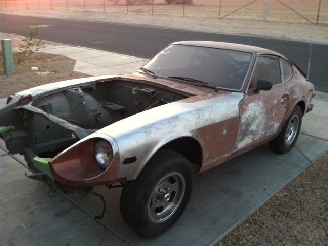

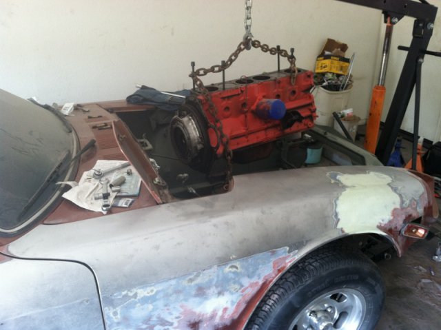

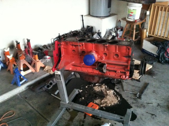

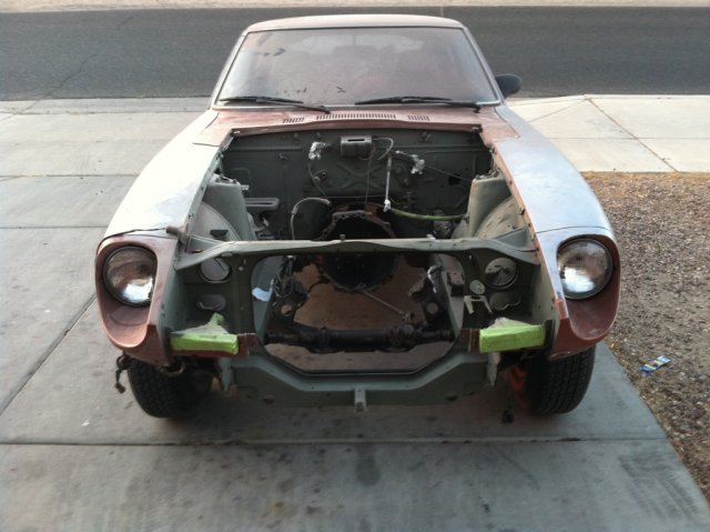

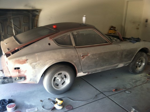

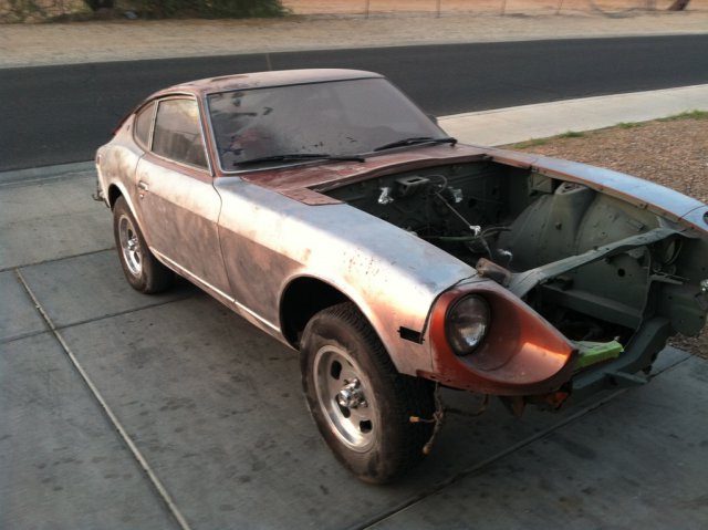

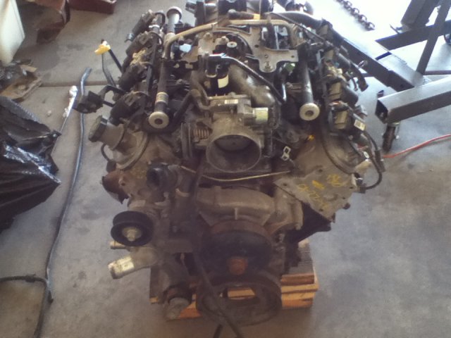

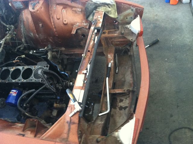

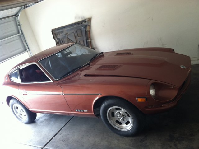

  1. Hello everyone Im starting a thread to show my progress on a 78 280z that will be running off a gm 5.3 Ive had the z for about a year now and Ive always wanted a gen 3 v8 in it since the day I bought it. I started work on the project recently and have been making good progress so far. I got the old l28, transmission and driveshaft out and have started sanding the body and engine bay. I also picked up a 5.3 down the road a couple of days ago My next step is to buy a transmission. My friend's friend has what I hope is a t56 in his backyard that hes going to sell to me for 400 bucks. I went and saw it a while back and saw that it had the borg warner logo on it. But I dont remember if its a t5 or a t56. Im really hoping its a t56, as Ive heard that the t5 cannot handle the torque of a ls1 style engine without making major upgrades that would put the price range of the t5 up there with the t56. I think the project will go smoothly but Im sure I will have lots of questions regarding the fuel system setup and the wiring. Ill try to post as much pics as I can Cheers! some pics of the project

  4. Hello I just finished taking out the drive shaft on my 280z. The engine and trans are also out of the car. But what about the 3 fuel lines that run along the frame rail on the passenger side? Can I remove them completely??
