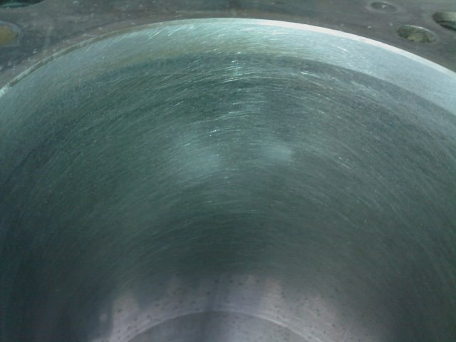

Alright, I ran my finger over that spot numerous times and I didn't feel a thing, then I put some 5w-30 on the cylinder wall and on the piston. I moved it up and down and it was smooth, it didn't catch anywhere on that spot. Can I buy magnaflux or whatever, would I have to go to an engine shop to have it done?

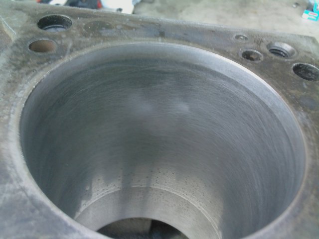

Well I was thinking about getting it bored out, but wouldn't that just make it closer to the problem? In my head I think the only solution is to get it re-sleeved and I think that would cost more then getting a junk yard block. But it will be quicker, I am going to go to several shops Monday morning and show them my block to see what they say. I rehoned the block today and here is a close shot and a farther shot, it looks a lot better but still not fixed.

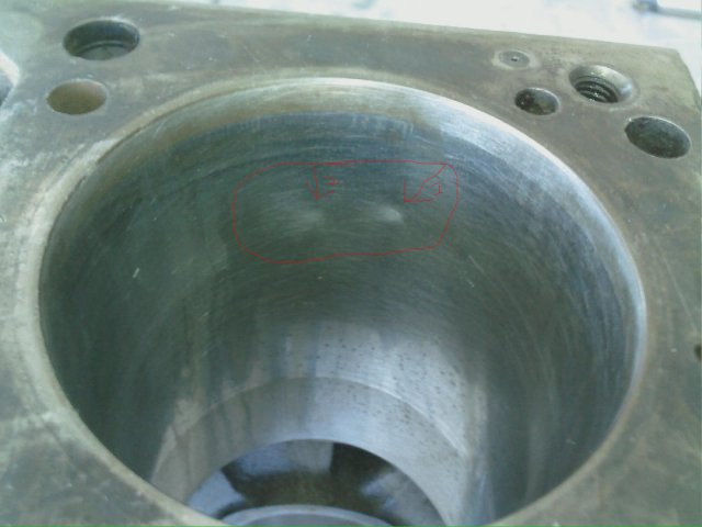

:cry2::cry2::cry2::cry2: I dont want to replace it, what would happen if I did run my car with this block, would it create a hot spot and blow at that spot only damaging piston #1? Also this is an f54 block and I plan to run about 15psi and in the long run 20psi of boost. I know its the smart/right thing to replace it, maybe I can pray to the z gods to bless my block? Plus no one got back to me about those ARP main studs torque spec. Also forgot to add thanks for everyones input, its been very helpful!

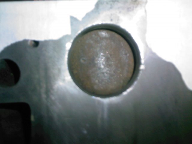

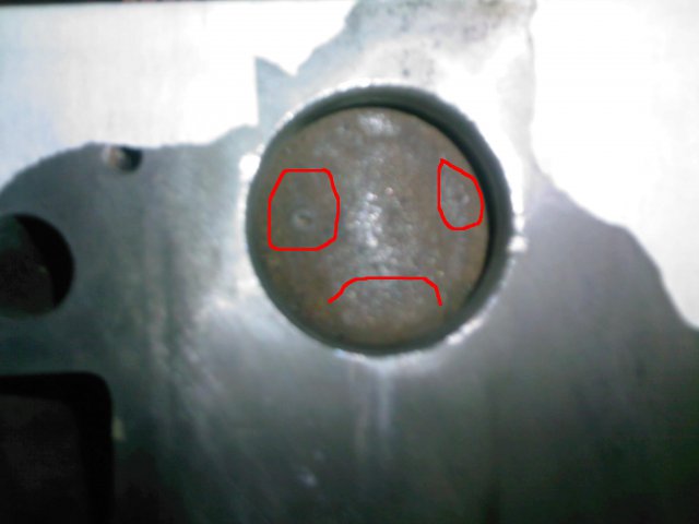

Well I did use a stone hone, but I think I know what it could be now. I looked at it again, when I was punching out the front core, welsh, or freeze plug (I said the three terms for it that I know to accommodate everyone) I had drove the plug to far in and it put a hole in the plug. It looked like I hit the cylinder wall from the out side and both those marks line up with where I hit it with the punch. The one on the right is more noticeable because thats the side I hit the most. So can I still run the motor hard with those spots and what should the torque setting be on my drill for the honing process because I had mine set to 10, I think.
As you can see in the pictures those spots are pointing toward the front of the engine block. But I am scared that those could be hot spots and possibly melt or blow a hole in the cylinder wall, what do you guys think? Also I forgot to add that I had bought ARP head and main studs along with rod bolts and I read on here that I had to torque the head stud nut just 10 more foot pounds, so that would make it 70ft. lb. not 60ft. lb. But I haven't read anything on main studs so would I just torque those down another 10 ft. lb. as well?
