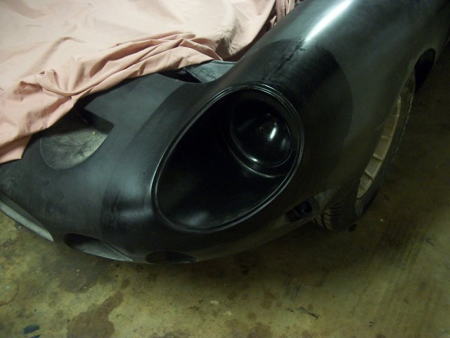

  1. Hi Mark, Have you done a set of clear lenses to mate up to the Tom McBurnie (ThunderRanch) 250 GTO kit? I am VERY interested in a pair! Thanks. I've attached a photo of the front end for reference. -Rod 1974 260Z Thunder Ranch 250 GTO kit 350 SBC V8 w/ T5 Trans R200 Rearend w/ 300z CV joints

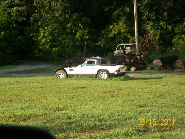

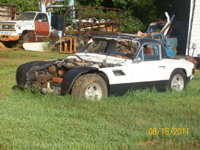

  3. Thanks for the quick responses, guys. Based on the feedback, it does looks like it has the Triumph TR6 straight 6 in it that would make me think it is the 2500M as well from wikipedia info . I had never seen one of these cars before. Thanks! -Rod
  4. Not a Z-related topic, but drove by a house the other day took a couple of pics of the this car out in the backyard. It looks like a early bmw z3, but the roof configuration confused me. That is not a removal hardtop. Any ideas? This is driving me nuts, and I've been google-ing around with no luck. -Rod
