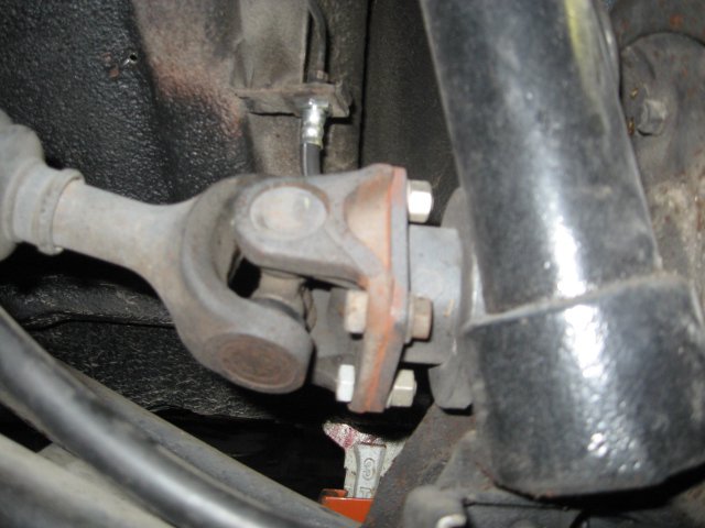

Hey Guys, Success!! I found the source of my rear vibration. It actually got worse when I took a another gear-head out for a short ride. It vibrated so bad, he was ready to leap out of a moving "Z". LOL! Anyway, after jacking it up, I started probing the half-shaft universals and found a couple of loose fastener that were hardware store grade crap. Then the real kicker was two of the drive-shaft to the pinion flange bolts were loose enough, that I could spend the lock washers. I plan to replace them all with grade 8 and self-locking nuts. Thanks to all who steered me in this direction.

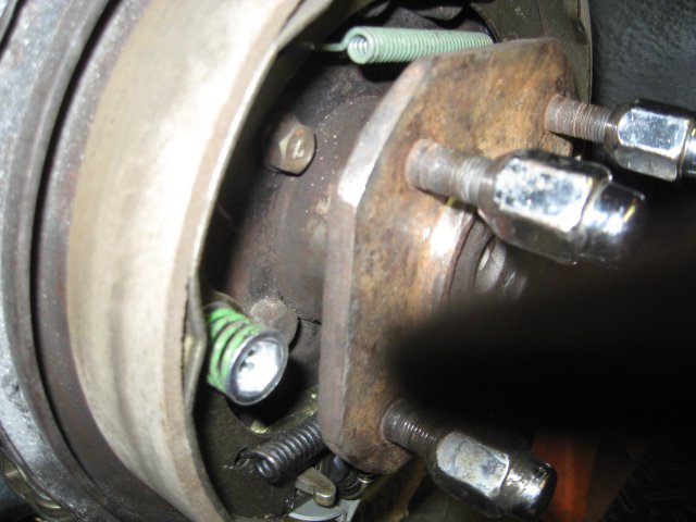

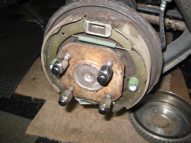

Hey guys, Regarding my mention of not seeing that "peened nut", I saw a drawing showing the wheel bearings and realize it's opposite of the wheel rim flange and I will need to gain access by first removing the out board universal from the inner bearing flange. When I mentioned servicing the bearings, are they the type of bearing, one would grease pack?
Hi, I much appreciate your reply. I'll take a look at this again. When I read through the shop manual for removing the hub bearing, there is no mention of any covered nut or grinding needed. After removing the wheel the hub has a solid center. Behind it are the 4 attachment bolts to the housing. My shop manual simply mentions to remove the 4 bolts, after disconnecting the universal on the other side. Then attach a slide hammer to the wheels studs and pop it out. See for reference....
Hey Guys, I went out for a roadie this weekend. Out of the "blue" I get this, somewhat, weird vibration out of the RRear. So, I get back to the garage, jack'er up, remove the wheels and start looking. I pull and tug on the universals, no play. While I'm there, I lube the outers. The inners seem to be a PITA. So, I'm rotating the axels and hear, like a dry bearing sound? It's smooth, but, noisy, if you know what I mean. Now, as far as history, I don't any, as I'v just take possession this past spring and the PO was not much on documenting anything. So, being new, where do these bearings get their lubrication, if any? I didn't find any thing loose that might cause a right rear vibration, thus far. The only thing I can come up with is wheel balance and bad rear shocks, at the moment. Any ideas?
