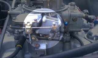

	Carburetor butterfly flap stuck?¿Datz350 replied to Datz350's topic in Gen I & II Chevy V8 Tech Board Lol!! Maybe...
	Carburetor butterfly flap stuck?¿Datz350 replied to Datz350's topic in Gen I & II Chevy V8 Tech Board Car starts up perfectly with the choke open. Lol, I'm sure you don't want to see a open diff burnout.
	Carburetor butterfly flap stuck?¿Datz350 replied to Datz350's topic in Gen I & II Chevy V8 Tech Board Alright, found out why my choke would close and why my idle was high. The rod thats holding the choke linkage is supposed to be bolted down. I, ignorantly, wasn't aware of that. The high idle was due to a tight throttle cable, again, I'm dumb, I know... Anyway, the car is running well now. I appreciate all your input, guys. Be well, friends.
	Carburetor butterfly flap stuck?¿Datz350 replied to Datz350's topic in Gen I & II Chevy V8 Tech Board Thanks again, guys. Once I get it fixed I'll post what the problem was.
	Carburetor butterfly flap stuck?¿Datz350 replied to Datz350's topic in Gen I & II Chevy V8 Tech Board " did not harp and continue on once I had RECEIVED AN ANSWER." I haven't received an answer. I was referred to a web link, which I had previously seen, which didn't help seeing it that the link only talked about automatic chokes.... And spoon feeding??? Really?? This is a automotive TECH forum. Not a online game to see who the best auto technician is. If you can't help me with my problem, then don't answer. I don't need your criticism, I need your help. Leave the criticism to the women.
	Carburetor butterfly flap stuck?¿Datz350 replied to Datz350's topic in Gen I & II Chevy V8 Tech Board Thanks for all the "mature" answers, guys. I took emeralds advice and, with no prior experience working with carbs, went out and, well, just FIXED IT! I even did it with my eyes closed, the carb gods, like Jason said, guided my hand... On a serious note, I'm just going to take it off and take it to a professional. Great idea!, huh?¿
	Carburetor butterfly flap stuck?¿Datz350 replied to Datz350's topic in Gen I & II Chevy V8 Tech Board I got the car this way. It was running great before. It never had a choke cable.
	Carburetor butterfly flap stuck?¿Datz350 replied to Datz350's topic in Gen I & II Chevy V8 Tech Board This is my carb. Why isn't the rod keeping my choke open anymore? Why does the choke close after throttle input. If I put a choke cable I would be messing with it during driving because the choke would close, causing high idle. The carb didn't do this before.
	Carburetor butterfly flap stuck?¿Datz350 replied to Datz350's topic in Gen I & II Chevy V8 Tech Board Via a cable.... There is no cable. What it has is a little rod. The rod has play to it, I'm not sure if thats normal. My problem isn't KNOWING what is wrong with the carb, it's finding out how to fix it. This is my first time messing with this kind of set-up. How does a manual choke work if there is no "choke cable". Trust me I have been looking around for info, but nothing that can solve my problem.
