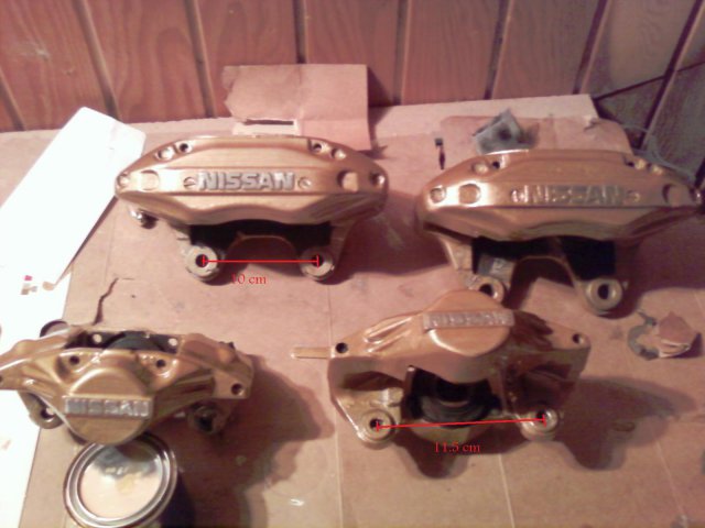

  3. Finally painted my calipers. I used G2 gold caliper paint kit. They look great! Cheaper and more durable than powder coating. Its all about the prep work... Prep work included sanding off some unwanted stamping (cleaner look), roughing up the stock caliper paint, wire brushing and spraying brake cleaner. Roughly 45 minutes of work. I also included the caliper bolt spacing diameter for front (10cm) and rear (11.5cm) calipers for anyone interested. I should be able to rig some brackets when I get home from school.

  6. Uhhhhh because they say Nissan on the side? Duhh! No, the calipers I am fitting are R33 GTS Aluminum 30mm. I was told they have much more pad area then the Toyota 4x4 swaps. In the rear I am using 300zx 2 pot calipers...for the sheer fact they say Nissan. Yes this build is about glitz and glam, but i believe this option is cheaper and just as effective as a wilwood conversion...if done right. Cost so far... Front calipers $200 Rear calipers $50 300zx 30mm 4 bolt rotors $120 280zx rotors $60 Additionally... Will need spacers (homegrown) Brackets (homegrown) Proportioning valve Anyone have faith????? Please?
