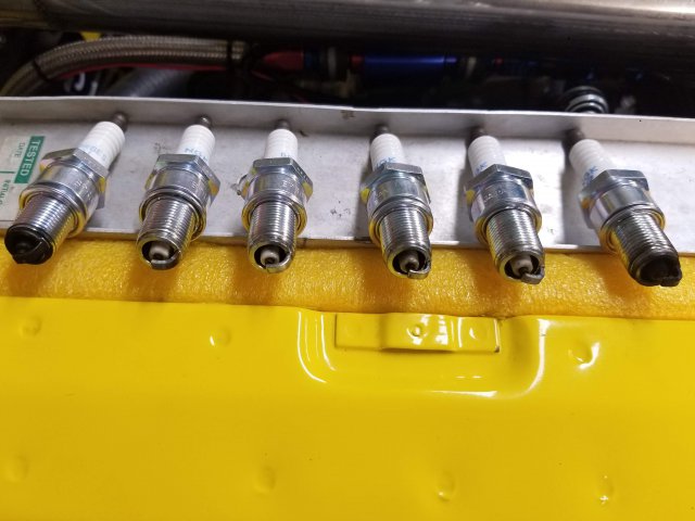

What do the plugs look like? Have you started with a fresh set? IMO, when you are trying to set a base tune, you will be going through ALOT of plugs. Post a pic of the condition of the plugs, buy a few sets of new plugs, make sure you 100% accurate with your trigger wheel offset calibration and we can start from there. Joe

I just realized I never updated this thread for people who were following. Well the problem was always timing. The biggest issue was the way the Quad Spark was wired. The way it was wired, coil 2 was in coil 1 position and coil 1 was in coil 3 position. Obviously that left coil 3 in the 2 position. When I was setting trigger offset, I was checking when plug number 1 was firing which was firing when cylinder number 2 should have been. Following? I know, a huge cluster f. I only found out what the issue was when I tested just 1 coil. I tested coil 1 and low and behold, cylinders 3 and 4 fired! I ten check the others and none fired the cylinders they were supposed to fire. Now I could have just moved the plug wires around but that would have been too easy. So I rewired the QuadSpark the way it should have been. After that, the got the plugs firing in the correct order and then reset the trigger offset and the damn thing fired right up! So yeah, I'm now an expert on wiring this damn thing lol. Now to finish up the tuning which I have been slacking on.

I figured out ignition offset. Got that set now. It was actually 66 degrees lol I just got the injectors back from being cleaned so I know they are working but I'm really at a loss now. I can get the engine started but lets just say it isn't running correctly. I threw in a set of fresh plugs and it started a little easier but then the AFR's went way lean and there was popping out the exhaust, caused by a miss. Pulled the plugs and this is what I find. I've also attached the log file of the start. Any ideas??? 2019-06-06_00.41.37.msl
Ok so a little more information. The TEC CAS mount put the CAS at 84 degrees after the missing teeth at TDC. So I now have 84 degree set for missing tooth #1 angle BTDC. I originally had this at 66 degree as that is what I had it set for on the TEC. I figured that would do it but not quite. What are you guys using for crank advance and can anyone share their ignition table? Thanks Joe
