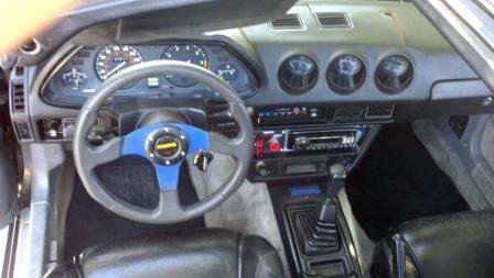

Thanks im lovin it. Yea u can if u have the analog cluster not the digi. You can just pull the cluster and swap out the bulbs in the twist locks but then you still have the tripod gauge stock color have to pop the dash off for that. Dosent take long and dont even need to completely remove it just pull it out on the right side to reach in.

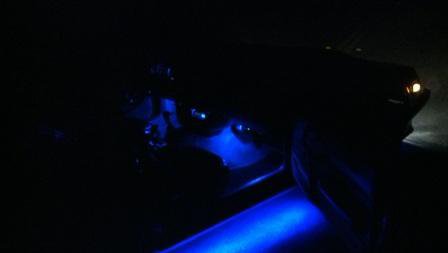

Thanks guys I've been having a blast with her been busy as hell doing things up. Will be posting some of the wrk I've been doing real soon... The color is awesome right!! I wish it wasn't faded in the few spots it is sm surface rust on pass door hood clear coat is pealing but still hanging in there.. I hear the turbos are really zippy in comparison to the NA motors.. can't wait to have a chance to go for a ride in one, or drive one lol. The interior lights are really cool the blue actually takes some of the on coming lights glare off the windshield and just makes the inside look awesome, between the dash lights all in blue the stereo and the floor lights it just makes it seem more fun to drive The under glow I really don't get you can't see it while ur driving. I guess for other people to see u coming but with the laws u can't run them on the road anyways... So got a question for u guys.. I've been trying to locate what front air damn and what wing is on my car just for personal info really.. do you guys have any idea?? The wing kinda looks like the street fighter on thezstore but mine is all metal not fiberglass... Thanks for the compliments and in advance for any info...
Thanks Blue, turned out that i was trying to upload from my phone and the file size was way to large.. So here we go tell me what you guys think!! And yes I know the lights are a 90's F&F fad but ehhh I kinda like them lol, plus when shes all up to par it'd be a cool addition for the car shows.. Feed back welcome!! Dont Know why the first pic is crazy big but ok?? lol
