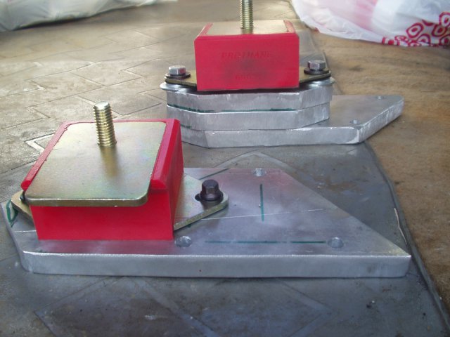

I have been on here learning alot about getting a small chevy into my 73 240Z. I bought the jrt book and built the motor mounts my self. I didnt like the idea of using a stock rubber mount that looks like it would rip in half with a beefy motor. So I went looking for an alternative and found some for a jeep that are polyeurethane. The mounts are not done yet, still need to clearance passenger side for the fuel pump boss. Just thought I would share.
