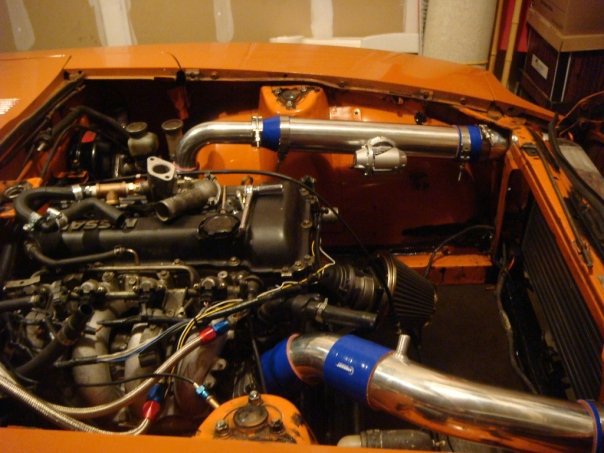

Originally I went to Tigerjdm. I wanted a blacktop s14. I had purchased a 4age from them a few years ago and so thats why i went back. All the s14s were located under the s13s and the employees were too lazy to move any of the engines for me to have a look at one. So I went to a place just around the corner but I can't remember the name of the place. Make sure you do a compression test on the spot. Also check inside the intercooler pipes for oil. They wash the engines, so its a little hard to know what shape there in. I paid $1800 CAD. That included the engine, tranny, ecu, wiring harness, ignitor chip. Thats a blacktop s13. I think the place i bought it from was http://www.torontojdm.com , although i'm not 100% sure. Also if you pay cash its going to be cheaper than what they advertise. I've attached a few pics. There better quality than earlier ones.
