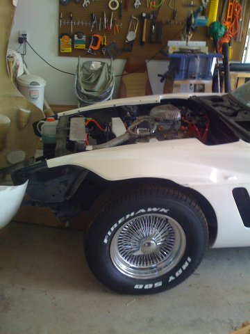

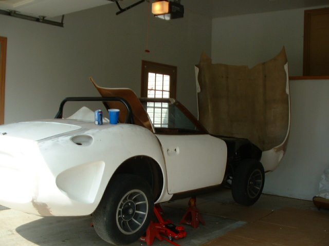

Here are a few pics prior, during tub set up. Also included it the prefabbing of the filler cap for those of you that might be doing this, it will have to be done before or during tub setup. dj
I have not sprayed the foam in yet and plan on waiting for better weather (winter in New York). I did not know about the water proof foam, good feedback. I have 4 cans of the stuff from Lowes, after some of the swelling horror stories I have read I am not looking forward to the foam part. I have ports in which to shoot the foam between the side walls, I know it is necessary to keep things from vibrating around and holding the tub in place, but thats about it. As far as the wrap arounds on the front of the tub, I would expect that it would provide some stability when riveted in place (see attached picture of my 916 project). The rear tub on the 916 was similar in design. As far as the doors, after grinding back I used filler on the edges and then wrapped 100 something grit around a 12" steel rule and sanded the slot between the door and the jam. I am truly an amateur at this, just letting you know how I did it. Looking forward to seeing more pics of your projects. dj
