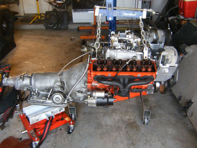

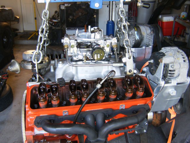

The motor is a 350 bored .60 over and vortec heads.  600 CFM Summit carb and intake with a Summit Camshaft, Hydraulic Flat Tappet, Advertised Duration 272/282, Lift .442/.465.
It has a 700R4 auto, just need the drive shaft built.

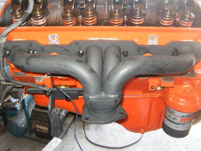

Sanders Headers

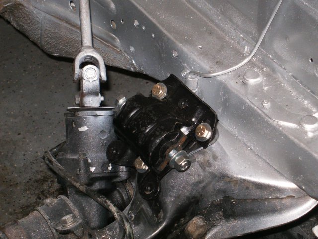

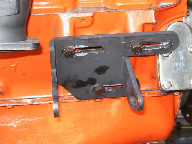

JTR Mounting Kit - Good Stuff in my opinion!

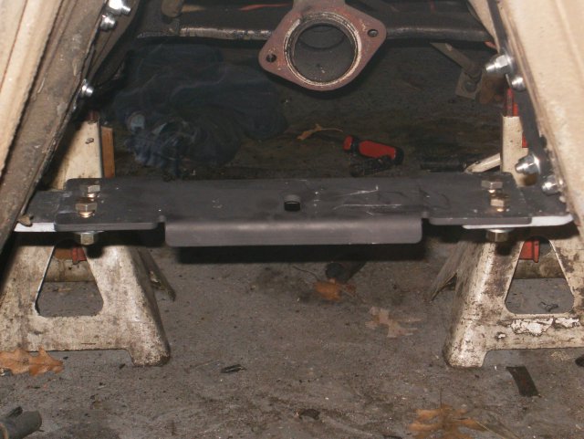

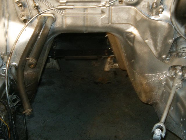

Transmission tunnel mods and new bracket installed

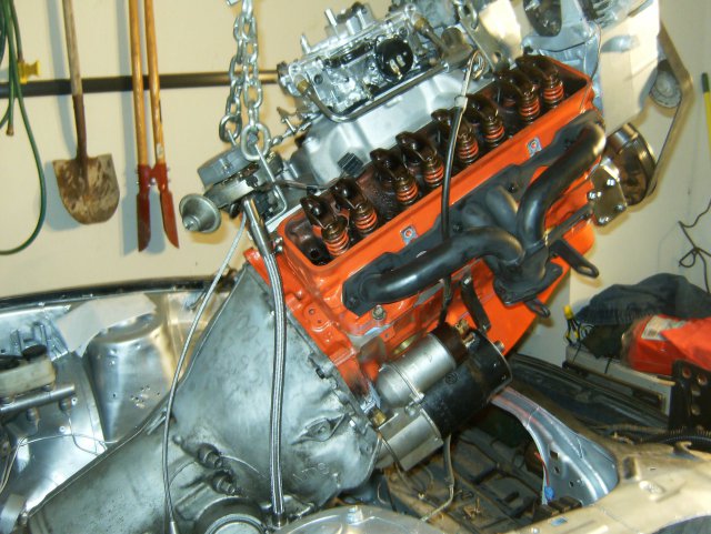

Tilting her in real easy like.

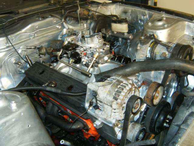

All in and tightened down.  The JTR kit really made the install go smooth.  I had the motor in the car in about an hour and a half.  Now its just putting the rest of the stuff back where it goes.  I'll add more pics as it progresses.
