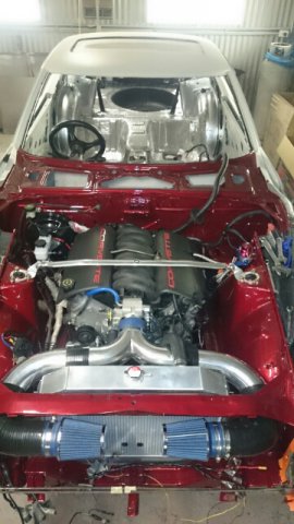

  4. Just a few pics of the diff I am running. Ps this is an Australian build.
  5. This is a diff from a Holden commodore as I am running a T56 with the LS1. All drive line from the donor vehicle.
