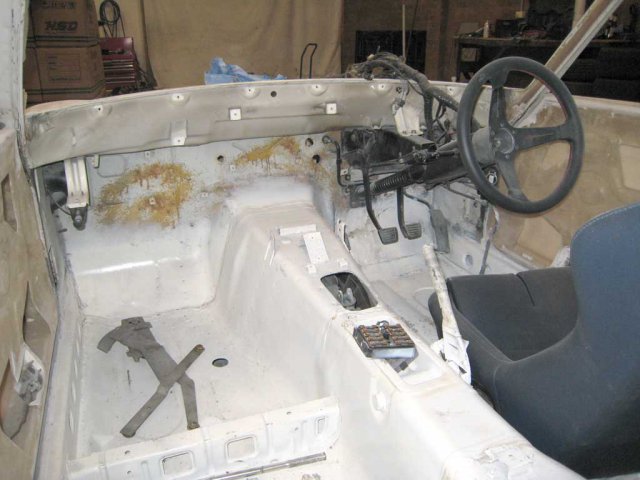

Some more progress on my 240Z project. I've attached most of the new panels. Unfortunately the doors won't fit properly with door rubbers in place, unless I modify the rubbers. Likewise the rear hatch. In the photos the new acrylic rear window isn't properly in, but I'm hoping I can fit it with the standard seal. More disappointing is the Hartman carbon fiber bonnet, which has a big curve on the right side making it sit up too high and also making it half an inch too short on that side. I will have to cut the frame underneath to reshape it. The carbon bumpers were very difficult to get in place, but they do fit properly at least. You may also notice the headlights, which are halogen units made by Raybrig in Japan. The blue tint to the reflectors looks pretty cool I reckon. The Bride seats went in quite easily in the end, using some generic rails which keep them nice and low in the car. I also bolted in a set of 3-inch four-point harnesses. The fiberglass dash was fairly easy to fit with some hand-made brackets and the original instruments fit too. I used a fiberglass vent panel ahead of the dash too, with the original plastic ducts riveted into place. I plan to hook these up to the side vent inlets, which are now blocked on the dash itself. At least I'll have some airflow to keep the windshield clear (the heater box and other vents are all gone). One more upgrade is the Watanabe wheels. I managed to find a set of 16x8 and 16x8.5 in a deeper offset, so I could get rid of the wheel spacers. The deeper centers look much better and they fill the fenders perfectly. A few finishing touches this week and I'll be driving DAT240 again for the first time in two years. Once the engine has been run in a bit I'll fit the new injection system. More on that later, along with a weighbridge result.assembledfront.jpgassembledrear.jpgbrides.jpgglassdash.jpgwatanabe.jpg
