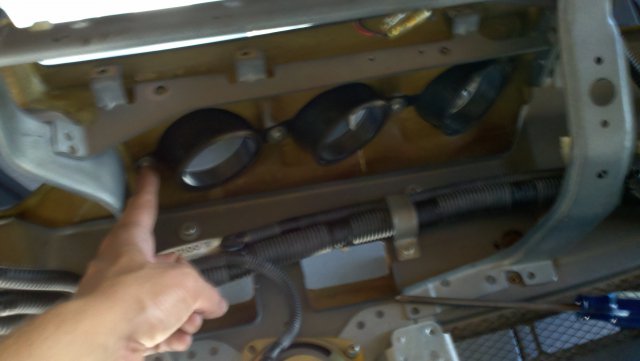

Hey guys, So I'm running into an issue after refinishing/painting my dash. In the process of taking it apart (after removal), the liners for the 3 gauges in the middle snapped each of their two mounting tabs that keep them in place. Now I’m putting it back together and having the darnedest time lining up the liners with the dash and the 3-gauge pod module – since they are staggered and at an angle and all, it’s juggling a lot and I’m coming up short. Any of you guys who have messed with an S130 dash have any ideas on how to better patch this up? I really want to finish this project – been at it for 3 months in my spare time and the garage needs the Z out! I briefly thought about just installing without, and then retrofitting some kind of liner from the outside of the dash, but I really have no idea how I would do that…maybe with small pieces of Velcro? Not sure if this photobucket image will imbed on this site (wirks for other v bulletin forums), but these are the bezels (pre resotration!) in question - there are liners that go on the INSIDE of the dash, between the dash and the actual gauges - they block the lights from the other gauges from bleeding out of the dash I think.... You can see the black looking liners between the dash and the gauge pod unit.... Thanks for any ideas! Phil
