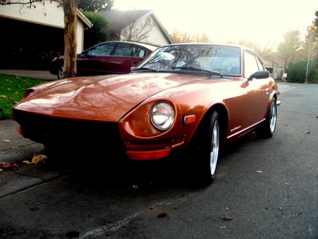

Beautiful car! Can any one tell me anything about the paint? Color code or color name? i look at the 918 orange but this is not even close. Ive never seen an orange quite like that!
