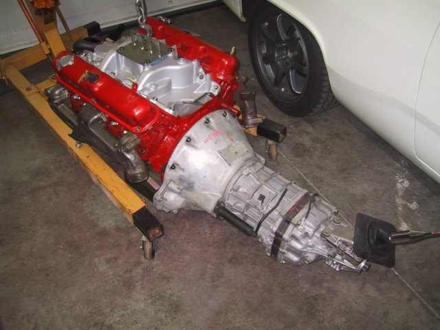

	Regal V6 mounts sound right. The Buick 231, 3.8L V6 and all small block Buicks use the same mounts. I'd say that's a good place to start. The 340 is a nice engine. It was only built for two years, 1966-67. It was superceded by the 350, similar but not quite the same. Heads are different on the 350. The 340 uses the Buick 300 top end and the Buick 350 bottom end. Believe it or not, aluminum big valve heads are soon to be available to fit the 340. Greg
	Is it your intention to swap the 340 and 2-speed in as is? Or... do you intend to build up the 340 a bit? None of the Chevy mounting stuff will work. However, if anyone has dropped in a Buick V6, THAT stuff will work. Same mounting points and mounts. Greg

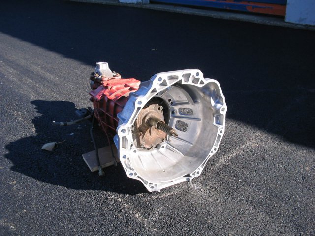

	The R154 will bolt to the Colorado bell with no mods. The W58 is less strong and won't fit any bell. You'd have to fab up something. Another option is to fab up an adapter plate like the Austin Healey guy did. The 4200 has the dowels for bellhousing alignment centered to withing .004" of the stock Chevy bell. If you put the Chevy bell up to the back of the 4200 using the dowels, you can fab up a plate to make it work. Greg

On the bellhousing issue. I've been told that two dowels in the 3 o'clock and the 9 o'clock position on the Colorado bellhousing line up to those of a Chevy V8 bellhousing to within .004". Using the Chevy bell as a template, it would be pretty easy to fab up an adapter plate. Greg -

Yes, you can definitely use an R154 to hook up a 4200 using the Colorado/Canyon bellhousing. The issues you'll have to figure out are what gear ratio's you want to use and where you want the shifter. Solstice shiifter is farther back than the R154. Greg -
