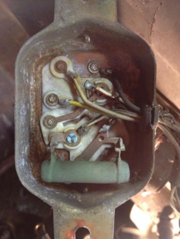

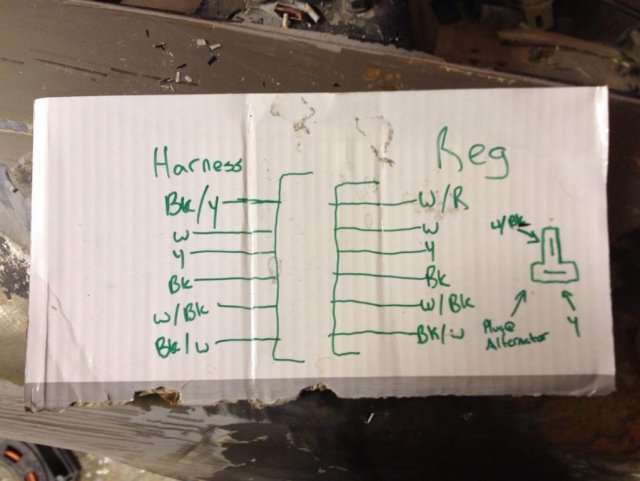

Good to hear napa took that back. Parts places are loathe to take electrical returns... I would be surprised if your alternator cooked before it melted down your battery (figuratively, but just barely). You might check your FSM, page BE 5 or so for the fuse value for that slot. Mine (1974) has 10A in the IGN flasher slot. Would suck to burn out a bunch of under dash stuff. I may be completely wrong as I am looking at a later manual. Don't sweat the regulator if it arrives mechanical; they work fine, and have for a long time. The comparison of mechanical vs. solid state regulators is similar to points vs. electronic ignition. They use slightly different voodoo, but both work.
I have an early 74 260z. The plug is different, and all 6 wires are present. Harness is in really good shape, as in untouched. Worked right last it was run. May be apples and oranges here but I'll post the images anyway in case they help. Good luck!
It sounds like the alternator field is not being regulated at all, but getting full battery voltage all the time. If your new regulator has a part number you might be able to find a wiring diagram for it online. I would personally ditch the mechanical one for solid state in a heartbeat, but I'm a little biased. Don't run the car until this is fixed or you will be buying a new battery, might already be too late. I'll run down to the shop in a minute and check what my reg looks like compared to your sketch.
