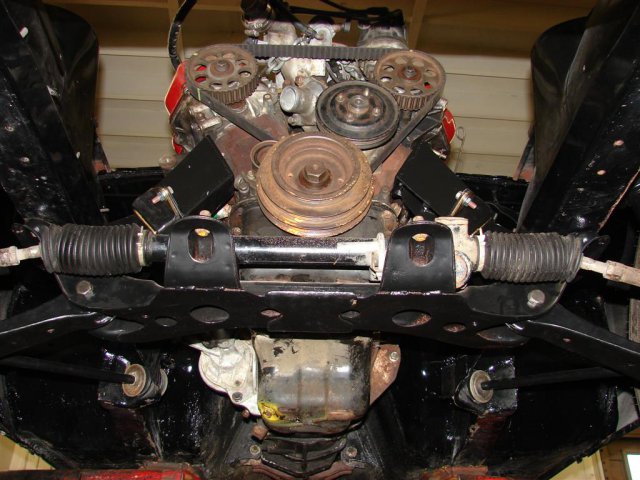

Small update, suspension and drivetrain stuff only. After a long wait I finally received my driveline and suspension parts from Modern-Motorsports. I ordered the coilover sleeve and spring kit, billet aluminum front hubs in zero offset, billet rear stub axles, and billet rear CV adapter flanges. I removed the old spring perches and installed the collar for the threaded sleeve to rest on. Painted the strut and installed the parts.....can I mention how much I hate grease! Here are the pics.
I will be making my own manifolds with a set of blank flanges I picked up a while back. I could use the headers from my extra VG30.com kit for a 510 and NA VG30 it to get it running quicker as the headers look like they would fit but I don't see me completing this anytime soon. I need to locate an engine and dash harness as mine has disappeared along with my good clean matching rear struts. Yeah once the motor was in the car the design just came to me and seemed like my best option. The only thing still left to work out is the alternator tensioner bracket, exhaust manifolds would be custom fab in most swaps anyway. Yeah, my winter car is an 86 Z31 na2t, but I still have an extra turbo motor kicking around. I should put my spare NA VG30 into it and turbo that but it's at home nowhere near my shop. I have too many spare engines.
The mounts are thicker than the cross member mount pedestals are and also thicker than original L-series mounts. The shifter is centered perfectly as you can see in the pictures so no problems in 5th. The transmission cross member I just left stock, I sleeved the original location for the cross member, ran longer bolts and attached the cross member to the back side of the floor mount. It's solid there and also makes the transmission perfectly located.
