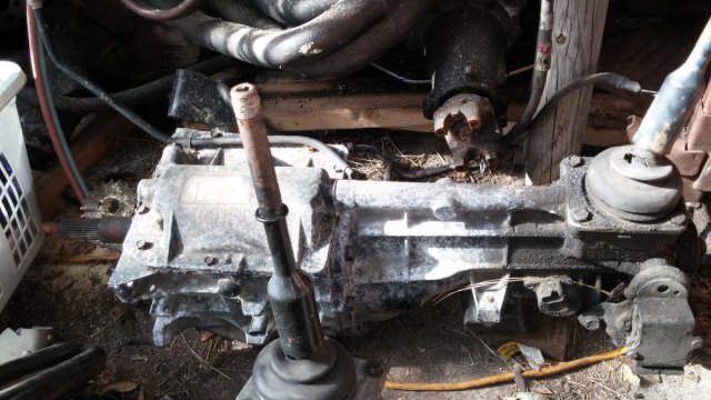

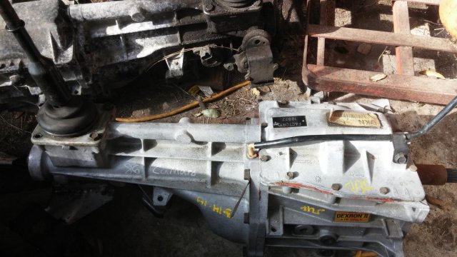

Picked up a T5 yesterday with everything, bell, clutch master, slave, hose. Flywheel, camero pedles (selling) shifter lever, clutch fork and camero cross member (selling or scrap) Now son need to clean it up, and start on removing the old 6 cyl.
If your close or want a road trip, I found these, he has two trannys but only one bellhousing. http://jacksonville.craigslist.org/pts/4421836379.html He gave me permission for to post his email ajsgurl2527@yahoo.com.
Looking at either a BW T-5 out of a 85 camero (need to find a bellhousing) or a NV3500 out of a 01 Silverado, this will be going behind a 383 using the JTR mounting brackets going into a 280zx (fairlady 280z) Car will be something like a daily/weekend driver, no track for right now. Which tranny would work (mounting) or would be better behind the 383. thanks

Found a T5 from a 85 camero V8, no bell though, $200, "rebuilt with hardned gears" would this be worth it and are there any years I should look at for the bell housing. Now need flywheel, clutch kit and still want to know if anyone kept the stock hyd clutch system or hodgepodge of stuff?
