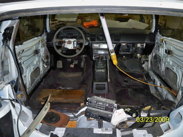

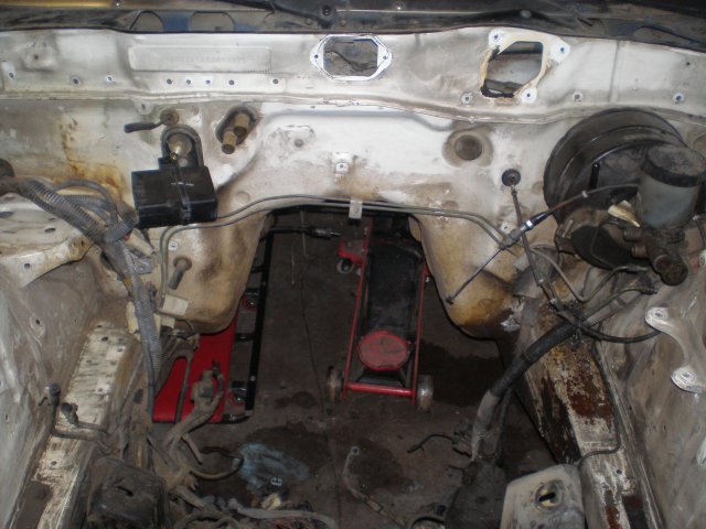

  2. Thanks, as far as mounts it's pretty much solid mount. I used the dett mounts on the engine and redrilled the holes on the z31 using a 1/4" nylon bushing between the two. On the trans I made a cross member and also used the 1/4" nylon bushing setting it nice and low. The wiring wouldn't been as bad if I had gotten the relay box and all with the engine harness but if you take the time It'll all work out. I've been working on it for about a year but not steady, that includes paint. By the time I bought the engine, trans, fly wheel, clutch, pedels, driveshaft, intercooler I was out about $2,800 which isn't too bad. Here's how it started.
