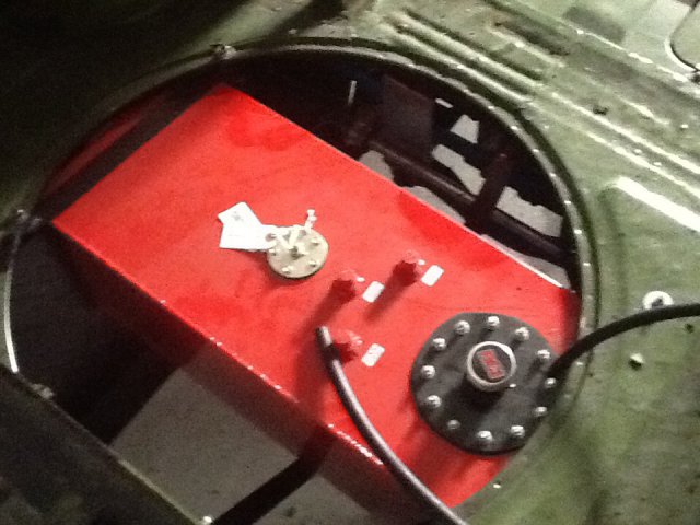

I added additional strapping because the kit they offer for this unit is meant to hold it in place, not really as "hangars". I think it'll take a few weeks before I can post install of Walbro and fab of chase, etc..
This: http://www.summitracing.com/parts/rci-2162ab Fit pretty well - maximum fuel capacity in stock location minus spare tire well with room for exhaust
Yes; stock external through same filler door. Going to loose interior space because the new filler is above original trunk area floor. This is where the Sheetmetal work is taking place.
Thanks Tim; we removed the tank anticipating locating I believe a '76 tank, the earliest compatible model with a baffle. We had the turbo motor, and we're replacing all fuel lines, etc.. A fuel cell became an easier to acquire option. Also, the $700+ cell-pump combos scared me off... We aren't going to run E85. I found a neck and breather combo which fits perfectly. Also a filler inlet at a 45 degree angle for the top of the cell. I will be doing some Sheetmetal fab around all where the spare used to sit. I'll post pics when I'm doing it.
Tim and New Zed: only item I'm still wondering about: the aluminum cell doesnt have an internal rubber bladder. I mounted it well with a lot of support with no potential for abrasive vibration, and it's in exactly the same spot as stock... Is there a reason to worry about this in a daily driver?
Thank you. This Walbro unit comes with a tray to compensate for the issue of baffles and efi swaps
The fuel cell not being tapped for an in-tank pump was okay with me until i read about overheating fuel, cavitation etc. (we arent running a super high performance motor -- pretty much a stock set up) Reading about how to overcome these potential problems brought me to two options: 1) the external set up; low pressure pump, swirl/surge tank, high pressure pump, reulator, return in minimum 3/8 inch line Or 2) drill out fuel cell for Walbro 255 with tray in-tank pump, filter and regulate externally continuing in 3/8 inch supply to inlet on rail, return to cell in 3/8 inch If the second schematic sounds ideal, i want to do it (actually, i ordered the Walbro last night in anticipation). Looking for the easiest to maintain and troubleshoot system. I already plumbed the new rigid 3/8 inch lines through the tunnel and hung the cell - this pump and return question is really a "What is best to do now?" Query.
This is quite the simple solution, but still requires a whole lot of joints and two pumps (potential for leakage, additional pump...) I think I want to just tap my rci fuel cell and install this: Walbro 255 Then regulate pressure, filter, hook up to my new 3/8 feed and come back in my new 3/8 return. That sound best to you New Zed?

Alright - thanks for the lead New Zed; I'm not wanting to reinvent what I've done so far. It's just the boiling of fuel / cavitation problems I read about troubled me. The submersible/in-tank pump seemed to solve that. I'll read about the Surge Tank
We're putting an '83 Turbo into our '72. We read about needing a later model tank to swap in, with a baffle, etc., and knew our fuel lines were insufficient -- bottom line, stock wouldn't work so we got it out of the way.
I think I screwed up; didn't like the cells with pump prices - damn! Pricey; thought I could purchase pump and filter and save @ $400... But the whole cavitation and overheating issue is something I was unaware of. So, now I toss the fuel cell and start searching for an all-in-one unit. Besides, I learned the single wall aluminum cell I was intending to use wasn't sufficient for the application; mounted where stock tank was, exposed, should have a rubber bladder for safety. Thanks for the feedback. Will post replacement system here when I find one. Submersible in-tank pump is the only way to go for these turbo conversions, is what I'm thinking.

Makes sense. Hopefully this fuel cell from Jegs will allow this option easily.... Thanks for the reply. 1) Submersible/in tank pump, 2) filter 3) regulator set at 40psi 4) connect to rail inlet 5) return from rail to tank Any other items in between I'm not factoring in? Check valves anywhere?
I just pm'ed Tony D on this -- man, there are a few threads talking about the heat and vapor causing cavitation, etc., especially when fuel level is low. These questions have me really questioning my set up; no more stock tank, fuel cell, new feed and return rigid 3/8 inch lines, a rollover vent... The pressure I'll need is 40psi constant for the turbo L28? So the inline pump I want has to deliver enough volume and pressure, and then needs to be regulated at 40... How to plumb this? Where is the regulator? Do I need a charcoal cannister? Cavitation issues worry me, pressure loss worries me, I'm a regular cluster__ of questions now!
