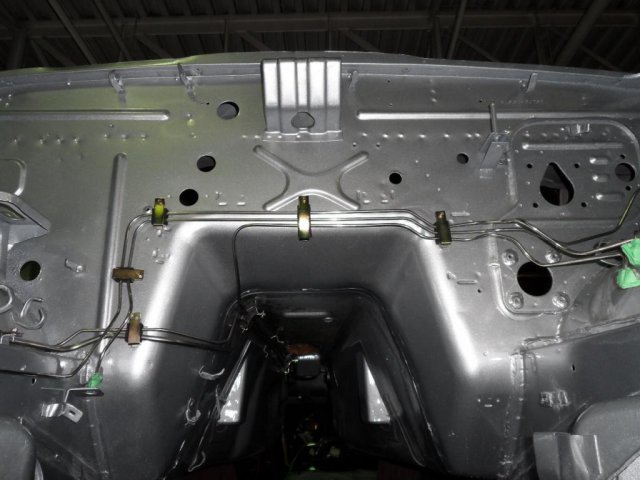

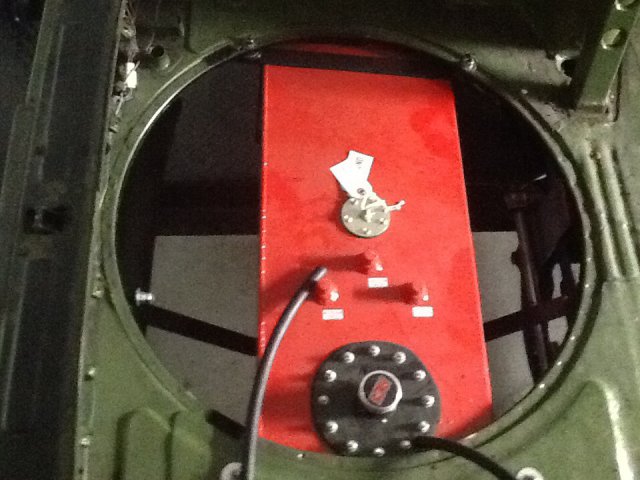

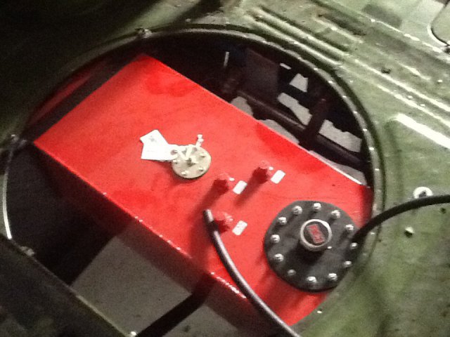

My son and I cut out the spare tire well and mounted a 15 gallon fuel cell underneath: We want to mount the pump right alongside the cell underneath. Anyone have pictures of a similar set up? Or thread suggestions? We'll be using the same filler location as factory via a new filler neck, etc.; welding a new cover over hole with a chase for filler neck. Any suggestions on fuel pump for turbo engine? Basic reliable pump sufficient for the system? Also, was planning on going with Fatts Rollover tubing schematic you find on Ratsuns http://www.pirate4x4.com/forum/general-4x4-discussion/243815-fats-fuel-air-trap-system.html#post2712471 and abandoning / removing canister from above and all the factory hose routings. Any thoughts? New filler neck comes with breather, and with rollover system planned, what other item should I be concerned with? I have new 3/8 feed and return rigid tubing plumbed through tunnel...

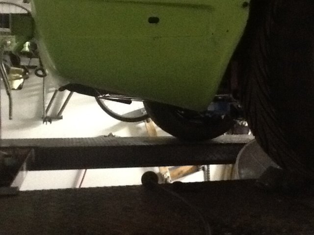

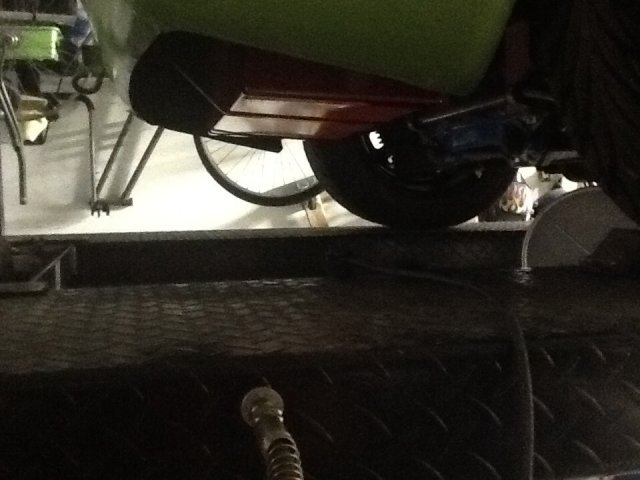

I have been stuck on this section of my son's build for a while now. I've got about an inch gap between the inner and outer fenders from cutting. I used riv-nuts (damned things spin around - about half grab enough to stay stationary) and screwed up by getting a similar look to your set up. Almost exactly; we hated the uneven gap over the top. Not wanting to raise the rear ride height, but keeping it set on the mid range spring adjustment on our coilovers, we elected to CUT MORE FENDER - my son wincing and saying "daaad, are you sure we should....". After the cut, and drilling new, slightly higher, riv-nut locations for our JDM flares, our result was: Well, I thought we had a picture with the flares on -- will post when we get her all welded back up. Bottom line: we adjusted and readjusted; moving the flare more forward, or down in front so the end on the rear was higher than the front -- same angle as the bottoms of the wheel wells themselves, if you follow. We liked this look better. My son kept accusing me of using the front flares on the rear -- and he had me doubting, because they are slightly different... The 16" x 10" rear set up sits nice and stout. Any thoughts or thread suggestions / pics on filling this gap?:

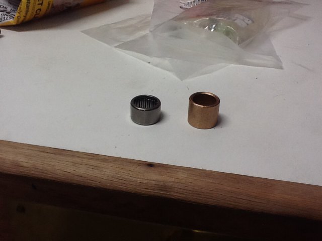

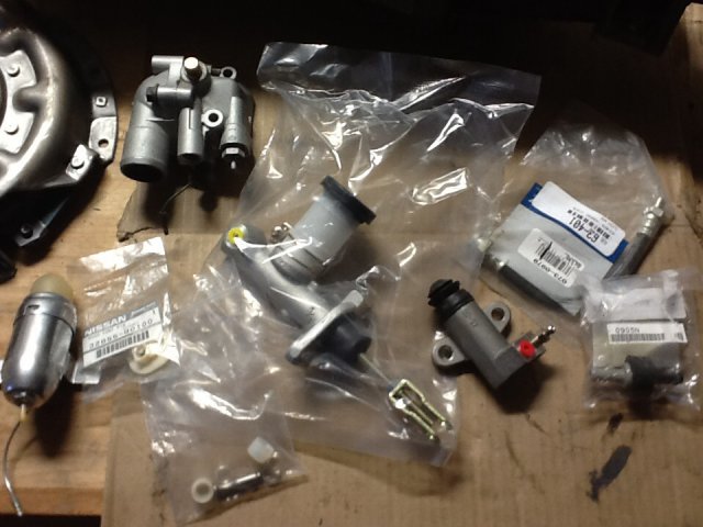

So, does anyone know why this "bearing" style pilot is shorter than the stock "spacer" style that came with my clutch kit? Also, wondering what performance value this "bearing" style will/would offer. Don't want to install this "just because".

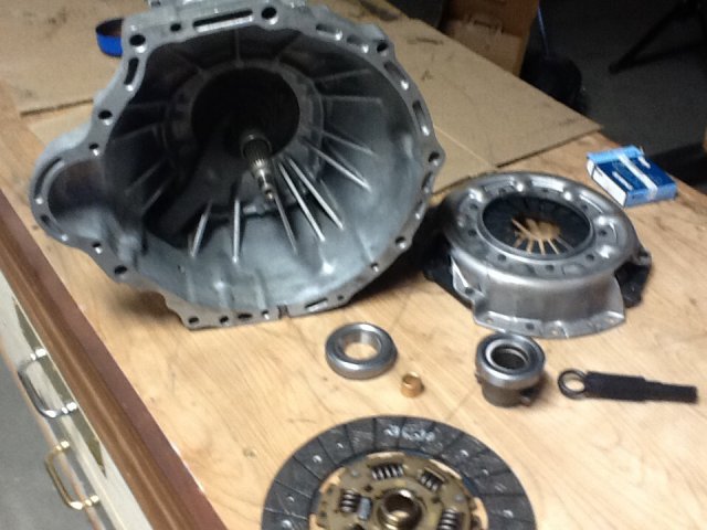

Dom? Hey, hoping you can help with a clutch question. I'm building a 72 for my son and we've got the L28 and T5 sitting on my shop bench. Problem I'm having is questions regarding the collar and throwout bearing. Got an Exedy clutch kit for the 240mm flywheel and it came with correct pressure plate and then just a single throwout bearing -- not mounted to a collar, like the other (wrong) 225mm kit had. This loose/single bearing is slightly larger than the one I've got mounted on the collar from the 225mm kit. The collar from that kit, I think I need; it's the longer of the two collars pictured in another blog where I found you. Appreciate your help
