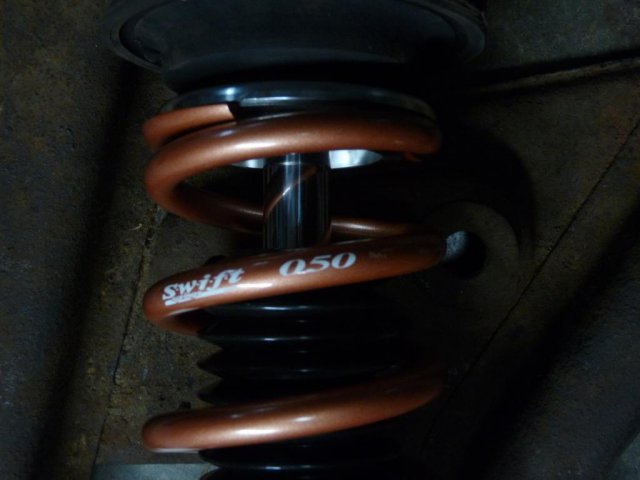

  2. 392 up front and 280 out back in lbs. swift springs are measured in kilos. still a little stiffer than than what has generally been recommended here. this is the first car that ive ever really built, so anything is going to be better to me than lowered on stock struts, slip over coils and 20yr old oe bushings. Jonc - i think since the coils arent really bolted in as of yet i will run some beads at the base if you say it needs done. i bow to your Z knowledge.

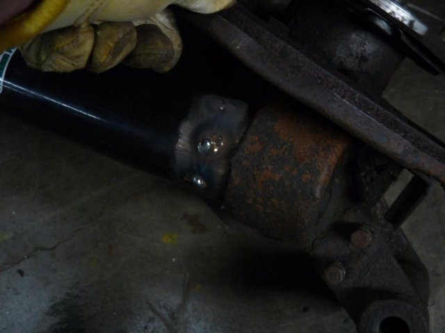

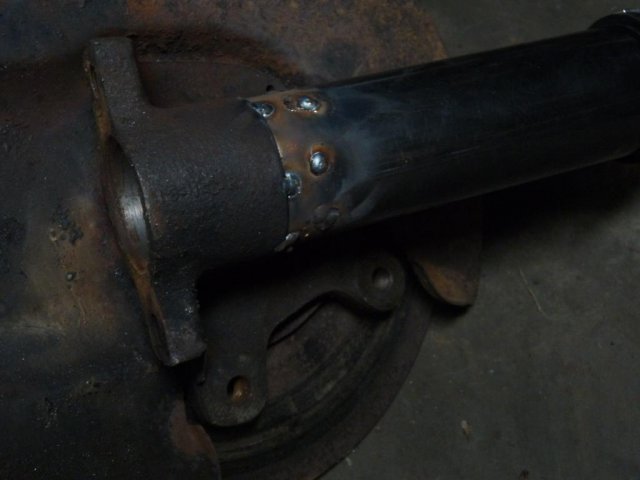

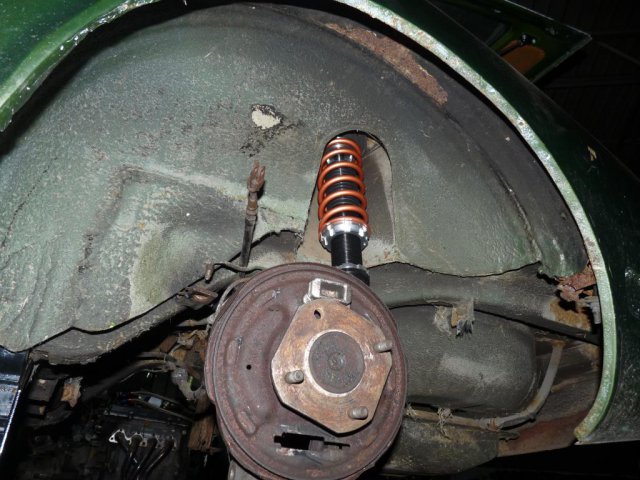

  4. the threaded perch isnt a press fit. those dots around the lower perch are holes that i drilled evenly all the way around and welded through. the lowers are basically plug welded
  5. the cost was 1350 same as their off the shelf coils, cost me 1,405 to my door. i thought that was pretty cool that they dont charge extra for a "custom" coilover setup. if your car is already on the the ground setup and you have the ability to corner weight it they will build dampers custom to your setup. without further a due or prcrastination from me lol you can somewhat see the machined step in the lower perch. this is a front and as you can tell no notch for the nipple on the knuckle so i made my own on the front that i have already done. yet to order the T3 bolt in camber plates so im still running stock top for the time being just to i can get cutting on the floors my weld job... i was freaking out about welding 400$ to not easily replaced pieces and having them end up crooked. so i hatched a plan and went over it with my welder friend. he assures me they will be plenty strong. im still a little nervous about it. rears. they're not the prettiest of welds but i burned em in good and hot. plenty of penetration. rear rates. my springs are way too stiff from what ive read here but its what odi suggested and was on the other sets that hes made. if theyre too rough ill change em up thought i had a pic of the front rates... guess not, theyre 700 pic of the only one bolted in the turd i mean car. little shop pic teaser. hope to have some funny vids form this place for yall this summer

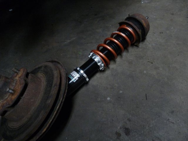

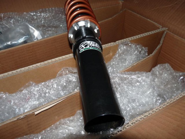

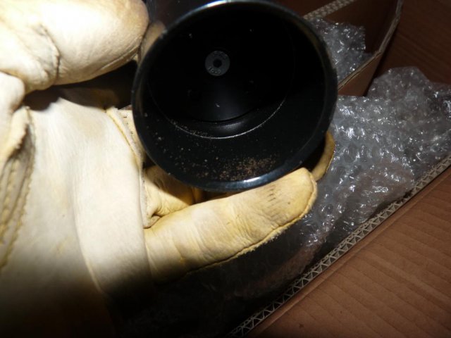

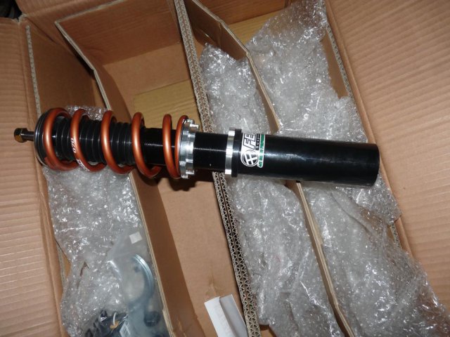

  6. sorry to anyone that's been keeping an eye out too much coffee and whisky trying to get some work done on the car. in total rush mode to be ready for summer. FEAL is good stuff from what ive seen so far. they will make coils for just about anything that can use em it seems. i spoke with odi bakchis owner to order them. He made it sound like they had done a few sets before. the kit is pretty nice. it comes with nice powder coated lower perches that you quickly cut,sand,grind, and weld. they do have a nice inner ring machined into them. i just cut the og tubes down just below said machined ring. I'll swing by the shop on my way to work with my camera get some pics of em before they're all installed.
