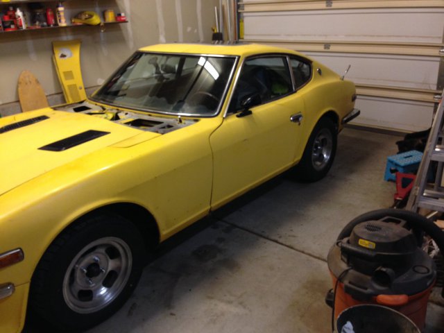

As far as intended use I would like to autocross, drive the car on road courses, and drive around town occasionally. My closes course is Utah Motorsports campus and I try to do events 1x per month. I haven't decided how much I can spend on wheels/tires yet and am just starting to look so I can set a realistic budget. For the wheel setup pic there is a pic in this thread a few posts ago that has a side shot where you can see the wheels. -

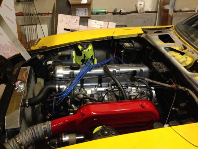

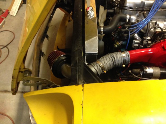

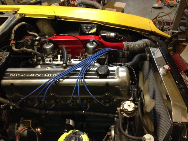

With the "new" engine in place and running there have been a few other issues that needed sorting out. On my first track day the fuel started boiling in the float bowls while running so it was time for a better heat shield between the headers and the carbs - yes these are ceramic coated headers and a better heat shield is still needed(not just a nice to have especially for track days). I built a new heat shield from scratch, it is hard to see in the pic but basically it looks like a park bench from the side without legs and covers the whole length but largely follows the style of the original with the addition of the flat bottom part. The place that is normally cut out is a bump in this version instead and the whole thing was covered with adhesive heat reflective/insulating sheet. This now keeps the carbs much cooler, so during driving there are zero issues. With this solved, I thought I was good to go but when driving on a hot day and letting the car sit for a while it starts perfectly but then it will die or become extremely sluggish. It died on the freeway which was a pretty scary experience. After looking around it looked like vapor lock so I searched around and found that insulating the fuel rail was a good way to fix this so I insulated and isolated the fuel rail. I first slit rubber fuel lines and put them over the original steel lines. I then drilled all of the mounting holes to .420 so I could put o-rings around the studs/bolts to prevent it from touching any metal. I then wrapped it with header wrap 2x. In retrospect the adhesive stuff that I used for the heat shield might have been better to not have exposed fiberglass around the lines, but either way after testing yesterday it looks like this problem is solved. It was attached with nylon washers on both sides so it is isolated from metal all around. Here it is completed and installed. After sitting for a while it is now a little harder to start, but once it starts it runs/idles great and doesn't die 1 mile down the road. I think what was happening is that the fuel would evaporate from the bowls first and then the fuel line would heat up and it would push fuel back to the bowls but leave the lines empty. So I am going to try isolating the fuel bowls from the heat even better, maybe add another layer to the heat shield or wrap the bowls. Either way it shouldn't leave me stranded in the middle of a freeway until it cools enough to drive. Yes I am still using the mechanical fuel pump and belt driven fan. -

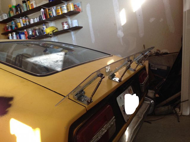

pic of the car After reading some aero stuff I covered some of the radiator opening with cardboard and made a plexiglass rear spoiler. This stuff actually helped hold me down on the track a little better with the side benefit of less exhaust smell. Since the cardboard worked it has since been replaced by a plastic piece that does the same thing but adds some stiffness to the air dam and doesn't look like a piece of cardboard. With the new suspension the car felt much closer to what I was looking for, but the engine wasn't quite up to par so I took the head off to see if there were issues with the engine. It looked a little worn, and had the dished pistons which means low compression ratio so it was time for a rebuild. Some details and conversation on the build are here The basics are: - N42 Block bored out 1mm - Flat top ITM pistons with balanced rods and ARP rod bolts - Casting imperfections smoothed - Turbo oil pump - Stock 280z valve sizes with SI valves and bronze seats - Late E88 head - L490 regrind - Aluminum sprayer bar - Light port and polish on the head and matched the header and intake to the head - ARP head studs - Fidanza flywheel and new clutch - MSA ceramic coated header - New seals all around - New harmonic balancer - New aluminum radiator, water pump, hoses, etc. - Cold air intake from stock air box with Norm's child toy modification (you can see it in the background of the engine block pic) - All new hardware mix of SS and higher strength steel bolts depending on location Including all machine work and parts the rebuild came out to around $3500 The engine runs great now, quick response and great acceleration. -

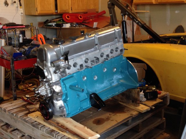

Well, I ended up building this motor, the cost was closer to $3500 than $2000 , but I ended up putting in ARP head and rod bolts and getting an aluminum cam oiler... I learned a ton through the process of building the engine and did all the little stuff like grinding the castings smoother and balancing the rods, and am pretty satisfied with the results. I ended up going with and Isky stage 3 and I don't know why you wouldn't go with a cam that big, no idle problems, works great with SU's etc. I sent mine in for a regrind - a great deal and got an aluminum billet oiling bar to keep it oiled. I kept my e88 head and did some light porting and moved to SS valves in the 280z sizes, I should be right around 10:1 compression. The car is pretty zippy and fun to drive. It does have some pinging only when letting off the gas completely, if I disconnect my vacuum advance this goes away. Under normal acceleration there is no pinging. Does anybody have a similar setup and if so how many degrees of vacuum advance do you run? Mine is set to 10 when plugged in and that is too much. I am also wondering if anybody has used a vacuum delay valve similar to https://www.oreillyauto.com/detail/b/bwd-3123/fuel---emissions-16775/emission-smog-parts-16465/vacuum-delay-valve-12054/0397dae098c9/bwd-2-port-egr-vacuum-delay-valve/ec314/2598329 (from the wikipedia article orange is a 2 second delay and white is forward direction - whatever that means) with the light flywheel it decelerates pretty quick and I think it just increases the vacuum almost instantly while the engine is spinning too quick. The benefit of the vacuum advance seems like it is mostly for cruising which shouldn't be impacted too much with a delayed advance. With the ceramic coated headers it still over heated the carbs with the stock heat shield on the track, so I built a new heat shield to protect the carbs from some heat and plan to drill some holes behind the battery and behind the windshield fluid reservoir to let some engine compartment air exit easier. The engine temps were fine, but it would be nice to cool the compartment a little more anyways, if for nothing else than to get rid of some of the header heat. I would also like to do an oil scraper, but am having a heck of a time getting one. I ordered one from https://www.crank-scrapers.com/Datsun-Nissan_L_SERIES.html about 3 months ago, and still don't have it and it is almost impossible to get a hold of them, my oil pressure is lower than I would like to see on the track. Any ideas where else I could get one?
