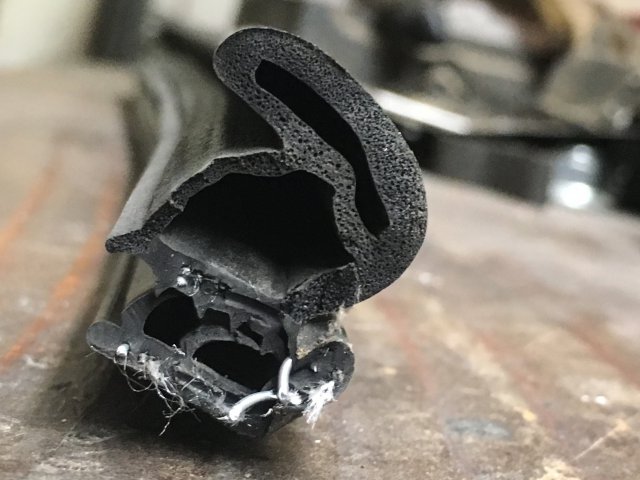

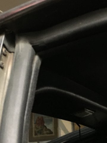

so after making many trips to the bone yard for kia sportage door seals I found a set of 2000 range rover door seals that are pretty close. they are a bit fat but work. the 90 degree corner at the top rear of corner two fits like a glove and then the rest just falls into place

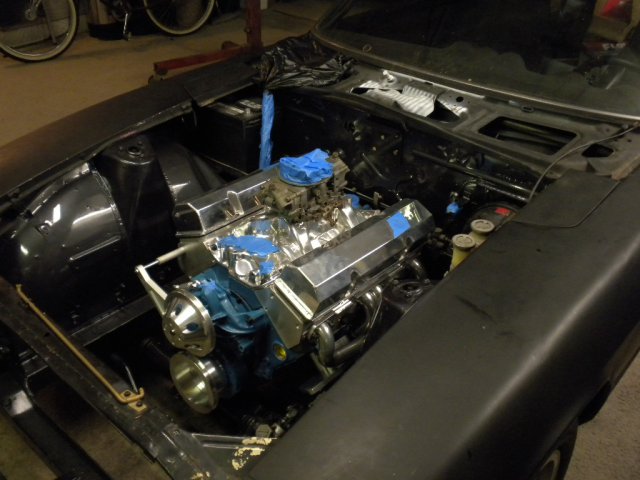

ok so i just started to drive my 73 240 with a 350 chevy and a t5 conversion ... it all works super but i think the r200 out of an 82 280z with a 3.90 gear is to tight. i go through the gears to fast, i dont want to do 200 mph but i do want a little punch.. if i leave a stop light in second gear it pulls super hard but if i go first second third i loose half the rpm cause i have to shift so fast any thoughs?????
