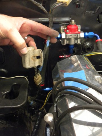

I have these left over wires and a relay that I'm not sure what to do with. Here's a pic of the relay and the harness in question, which goes over to the windshield wiper motor (upper right). Upper left is the connection to the windshield wiper reservoir motor and the the brake proportioning valve. Do I need the brake proptioning valve wire? What is the relay for that is shown in my hand? This is a jtr v8 carb conversion on a '73 240Z.

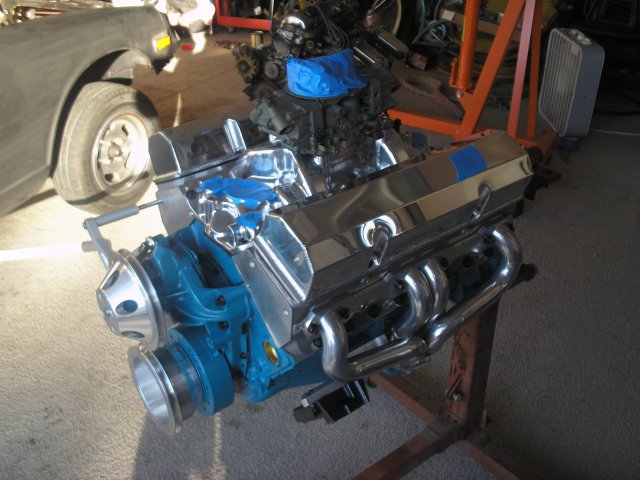

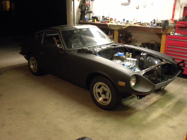

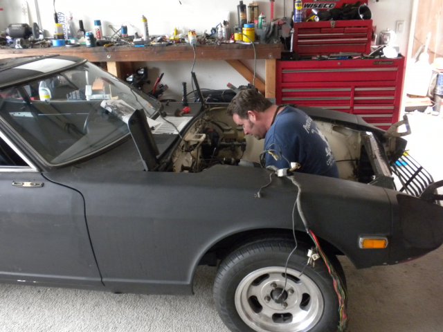

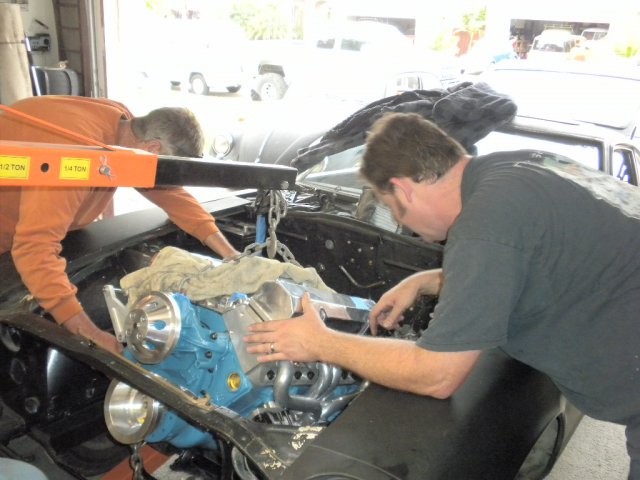

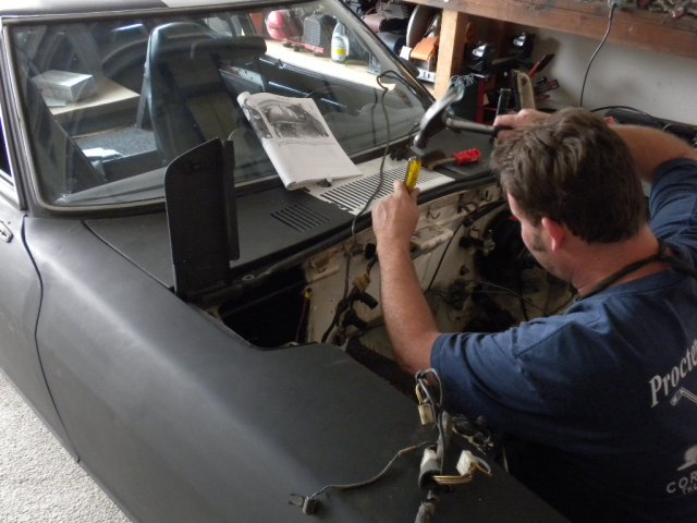

Finally some pics of my 73 240 gettin fixed
hpltree replied to hpltree's topic in Gen I & II Chevy V8 Tech Board
thanks for the comments, yes it fits like a glove almost like it should of been born with a v8 in it -

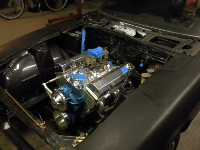

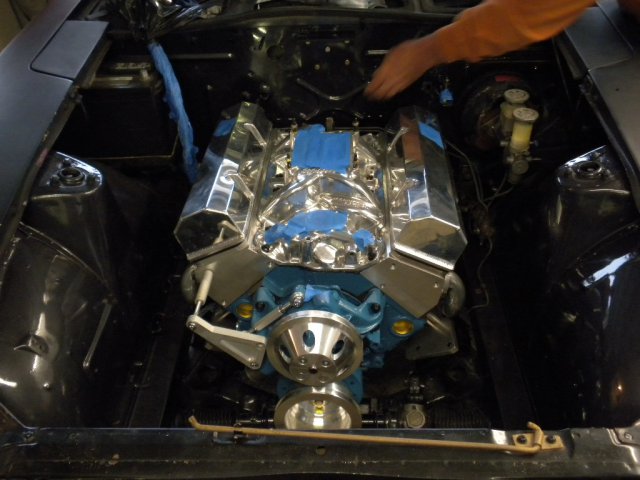

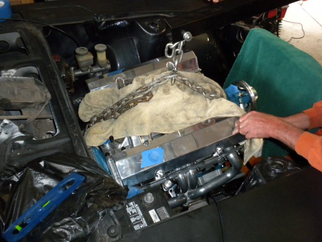

it is friday and it is in finally thanks again, i hope you all like it as i do . i think it looks super in there with the metalic paint -
the motor and trans out of this car is for sale, it has the weber 32/36 s and is a bit tired but i have a video coming soon showing it running -

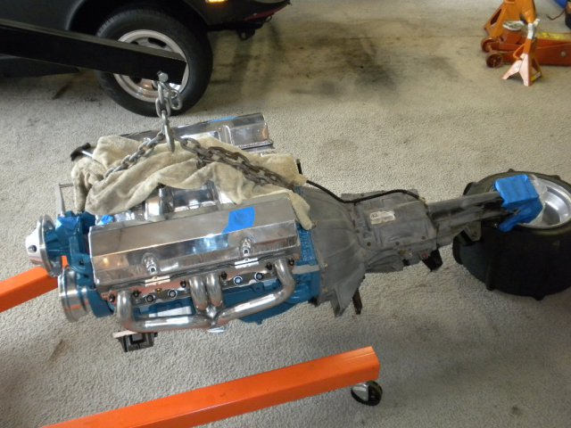

i have a bunch more pictures but i was waiting to see if these are the right size -

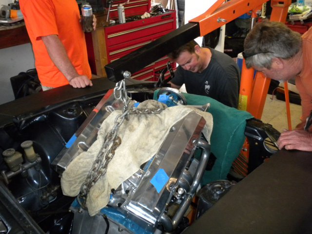

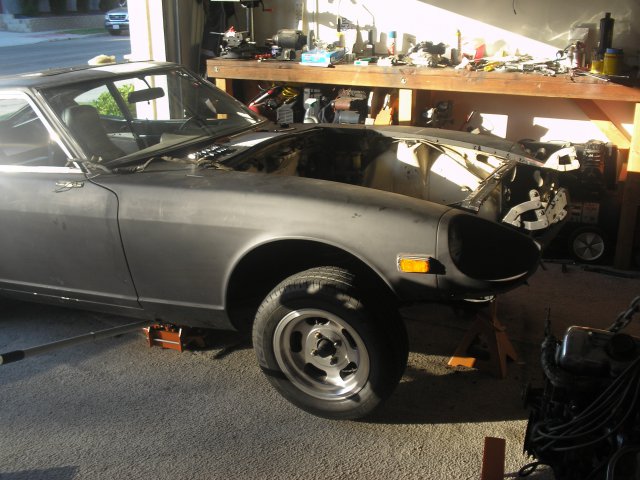

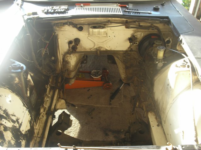

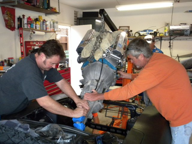

hpltree posted a topic in Gen I & II Chevy V8 Tech Board

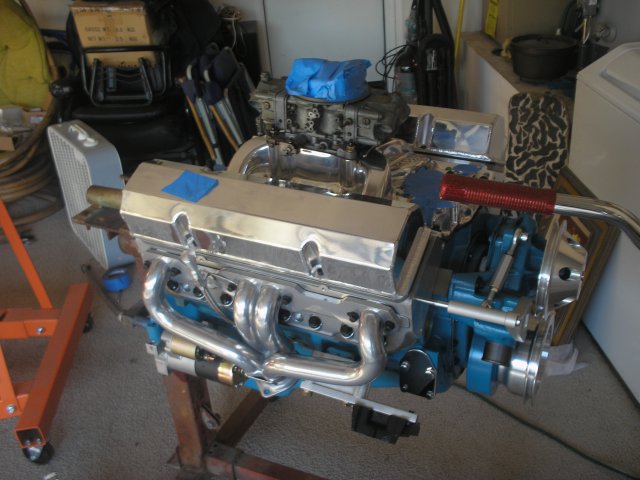

ok these pics are a bit large but nobody helped me fixed them so here you go............ thanks for all the info this site has been very helpfull
