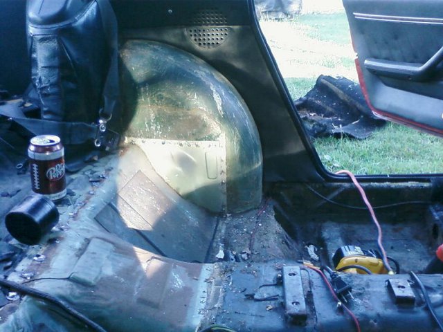

well i was going to run it inside a piece of tubing ran along side the rocker. the it would be out of the way. i could secure it up out of the way the whole way from front to back, there isnt that much wiring to be ran. the factory wires are plenty long enough. just cut them and re-route. the battery will be relocatied to the trunk. can someone tell my why it would be a bad decision to mount my main hoop inside the fender wells? i could make a large plate to weld it to, so as to better distribute the forces on the floor pan. any advice is welcomed please. i want to hear evreryones opinions.
yes, all i did was drill/grind out the spot welds, and remove the angle piece. that is what it looks like with it removed. i plan on doing a roll cage with the main hoop just inside the fenderwells. hopefully giving me more seat room and not having to bend a angle into the main hoop. allowing it to go straight up. only problem is i will have to have a bend in my door bars to meet wih the main hoop. actually there is verry little rust in this car. the floor pan/frame rail was bent up a lil on the driver side but a mini sledge fixed that. this car is extremely solid. for 600 bux. wow.
i decided to remove the piece of metal that makes the 90 degree box right behind the seats. i think it looks better that way, as i am going to sand blast the hole interior and remove all sound deadening and paint the whole floorpan front to back with bedliner spray, and will only have the door panels, and the panels that cover the sides infront of and behind the wheelwell. i will have a full cage built so im not worried about any strength that i have lost from removing this. i was wondering about putting my main hoop between the fender wells instead of infront like everyone else. should give more room for seats. also, ALL wires will be ran under the car, so that will allow the inside of thecar to stay slick with now exposed wires. please give your opinions and i will post more pictures as i progress.
