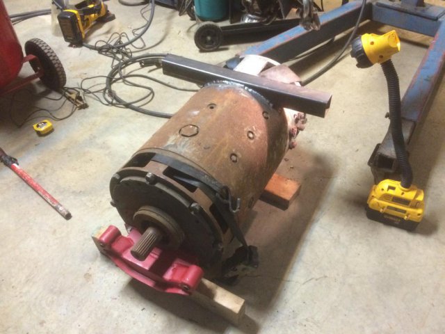

  7. Well I removed the engine, transmission, radiator, starting battery, exhaust, all the fluids as well as the gas tank. What does all that stuff weigh? I'll assume I removed about 700 pounds from the front and around 200 pounds from the rear (assuming the gas tank was holding fuel). I've added around 600 pounds to the front, with the bulk of that shifted down and back substantially. So in total I figure the car is perhaps 300 pounds lighter than stock. The motor was originally from a 16,000 pound hyster forklift. I got a fantastic deal on it, along with a few others. Around $500/each. if you were to buy something like that new it would be around $5000. Getting the coupler machined to adapt the 29 spline 1.875" shaft to a 1350 u-joint cost about as much as the motor. Though a Warp 9" motor that would typically be used in this type of conversion costs only $1800 new and weighs just 130 pounds. Even that would be more than capable of breaking the tires loose. In fact you can't actually buy a motor this big. The next best thing is the Warp 13" which is 1/2" smaller (less diameter = less torque, more speed) and substantially shorter (again, less torque from less armature surface area) I also just finished getting two of those 13.5" motors mounted between the frame rails in a Dodge Ram. One driving the front wheels and one driving the rear. Full time 4wd with no steering issues or surface limitations. Since they are wired in series I'm getting 1000 ft-lbs of torque to the axles per 1000amp of controller.

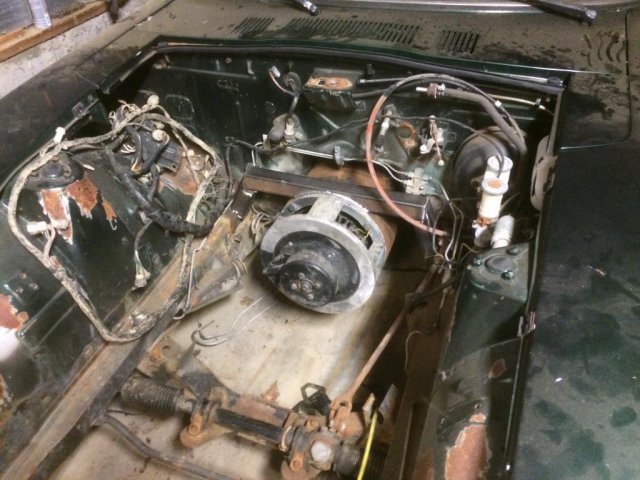

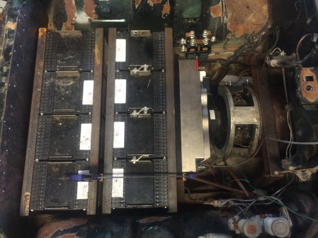

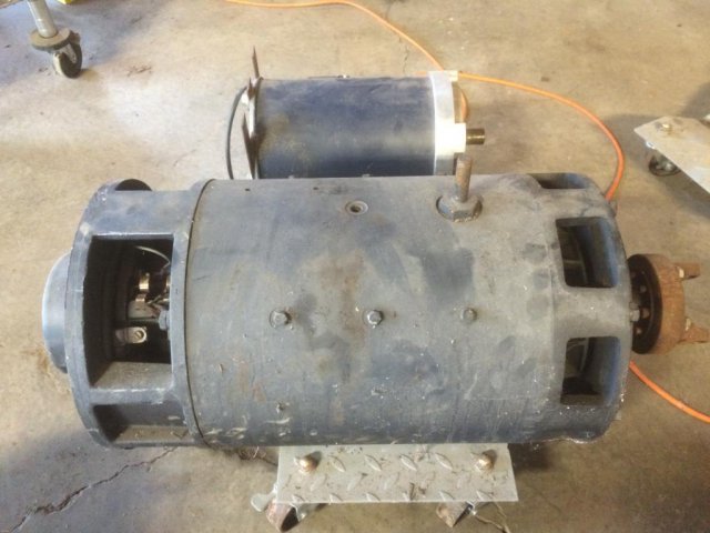

  8. So I've managed to shove an absolutely monstrous electric motor into my 76 280z. This isn't my first electric Z car, but it's different from my first in just about every possible way. For comparison the motor on top is the size I put in my first one, and on the bottom is the motor I've got in my 76 now. Previously I kept the stock 4 speed transmission and fabricated an adapter plate to mount the 8" kostov motor. This time I dropped the transmission entirely and went direct drive. That allowed me to mount the motor deep into the transmission tunnel with just a little bit projecting into the engine bay. I've completely blocked off the radiator opening with a steel sheet. It's outfitted with high-output lithium batteries that are rated to 15C discharge which is 1,500 amps. Each one of those stacks of 4 batteries is ~65v fully charged and ~40v when empty. They're also rated to charge at up to 6C which would be a full charge in just 10 minutes. The controller is a Soliton 1 that will do 1000 amps continuous at up to 310 volts. At full output thats 400HP but I'm running at a lower voltage than that. I've yet to turn up the power but preliminary testing shows it will break the tires loose on dry pavement even with my brakes dragging. Though if I find one for sale I'd love to get my hands on a 3000 amps soliton shiva. That would take me from 500 ft-lbs to the diff up to 1,500 ft-lbs. The motor is capable of way more than what I'm feeding it now. Now that the mechanical stuff is done I'll be pulling it all apart to paint the engine bay and battery racks. And I'm going to need to address my brakes and headlight/turn signal wiring before I can get it inspected and on the road. I'm definitely going to go with rear discs but I'm trying to decide between the maxima caliper/rotors or the wildwood setup.
